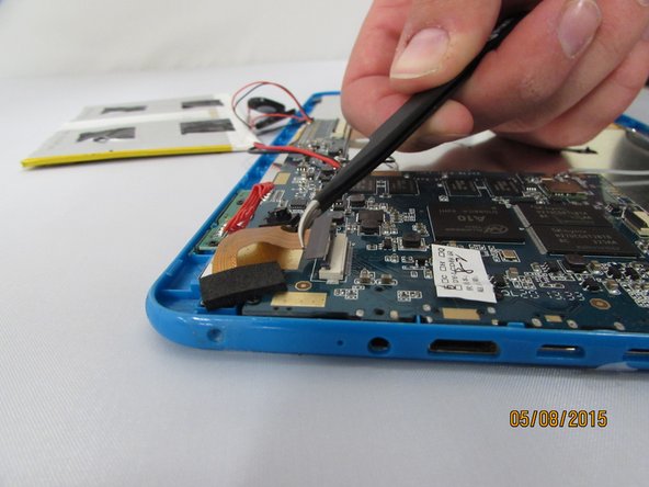

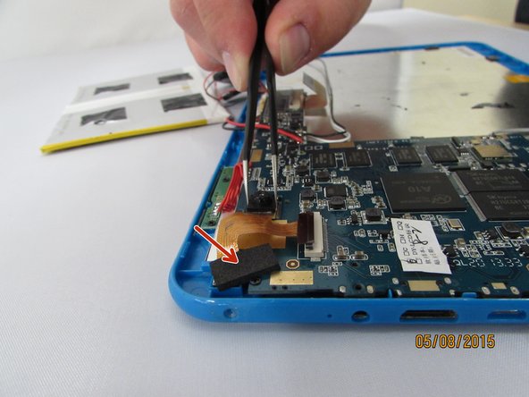

    1. Visual Land Prestige 10 Digitizer Replacement, Front Facing Camera: crwdns2935265:08crwdnd2935265:01crwdnd2935265:03crwdne2935265:0 Visual Land Prestige 10 Digitizer Replacement, Front Facing Camera: crwdns2935265:08crwdnd2935265:02crwdnd2935265:03crwdne2935265:0 Visual Land Prestige 10 Digitizer Replacement, Front Facing Camera: crwdns2935265:08crwdnd2935265:03crwdnd2935265:03crwdne2935265:0
      • Locate the Camera Housing. Gently grip and lift the small black tab until you feel an audible click.
      • Gently remove the connector by pulling straight out, gripping the black connector head or as close as possible.
      • Gently grip and pull up the front camera, covered by protective adhesive foam.
      • Set aside the Camera housing.

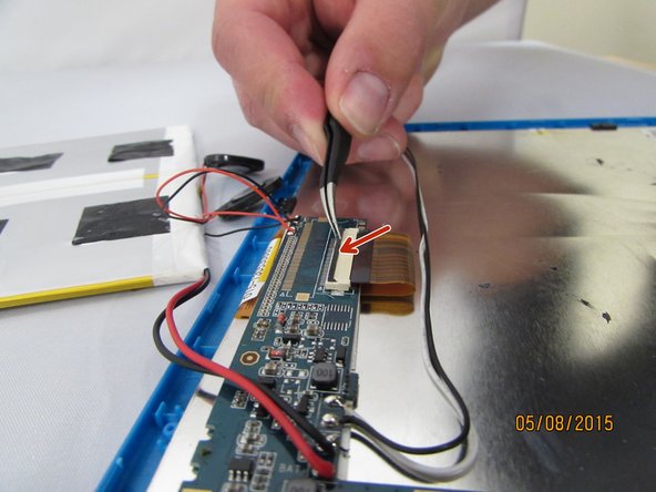

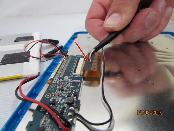

    1. Visual Land Prestige 10 Digitizer Replacement, Motherboard: crwdns2935265:09crwdnd2935265:01crwdnd2935265:03crwdne2935265:0 Visual Land Prestige 10 Digitizer Replacement, Motherboard: crwdns2935265:09crwdnd2935265:02crwdnd2935265:03crwdne2935265:0 Visual Land Prestige 10 Digitizer Replacement, Motherboard: crwdns2935265:09crwdnd2935265:03crwdnd2935265:03crwdne2935265:0
      • Locate the LCD Connector.
      • Using tweezers, grip the small black tab connected to the white plastic.
      • Gently lift the tab towards you until it clicks.
      • Remove the connector by pulling straight out, gripping the black connector head.

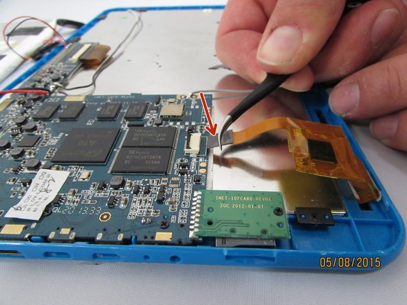

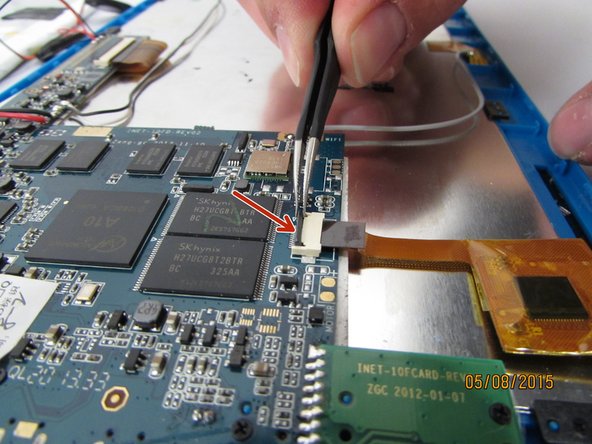

    2. Visual Land Prestige 10 Digitizer Replacement: crwdns2935265:010crwdnd2935265:01crwdnd2935265:03crwdne2935265:0 Visual Land Prestige 10 Digitizer Replacement: crwdns2935265:010crwdnd2935265:02crwdnd2935265:03crwdne2935265:0 Visual Land Prestige 10 Digitizer Replacement: crwdns2935265:010crwdnd2935265:03crwdnd2935265:03crwdne2935265:0
      • Locate the Touchscreen connector and grip the forward-most black tab with the tweezers.
      • Lift the tab towards you until you feel an audible click.
      • Gently remove the connector by pulling straight out, gripping the black connector head.

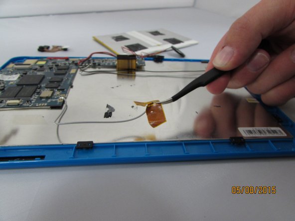

      • Gently lift up the WiFi antenna and set aside.

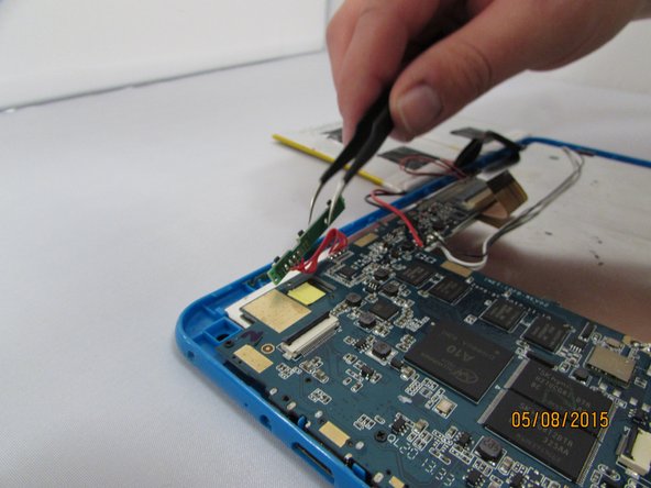

    4. Visual Land Prestige 10 Digitizer Replacement: crwdns2935265:012crwdnd2935265:01crwdnd2935265:02crwdne2935265:0 Visual Land Prestige 10 Digitizer Replacement: crwdns2935265:012crwdnd2935265:02crwdnd2935265:02crwdne2935265:0
      • Locate and remove the screws holding the volume and hold button controller. Set screws aside on magnetic mat and label them.
      • Gently lift up on the controller and leave it hanging loose.

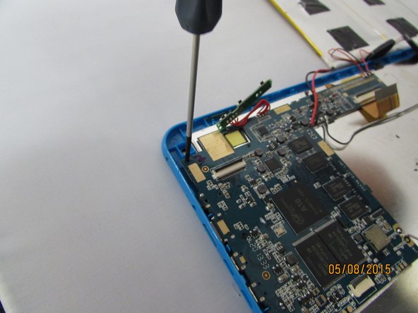

    5. Visual Land Prestige 10 Digitizer Replacement: crwdns2935265:013crwdnd2935265:01crwdnd2935265:02crwdne2935265:0 Visual Land Prestige 10 Digitizer Replacement: crwdns2935265:013crwdnd2935265:02crwdnd2935265:02crwdne2935265:0
      • Remove screws located on motherboard.
      • Place on magnetic mat and label them
      • Gently remove the Motherboard and any wires connected to it and set it aside on a static free surface.

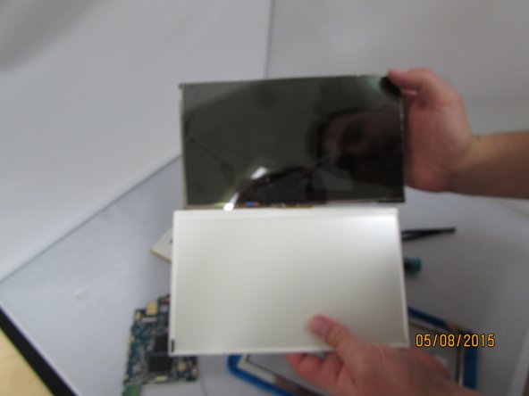

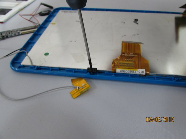

    1. Visual Land Prestige 10 Digitizer Replacement, LCD Display: crwdns2935265:014crwdnd2935265:01crwdnd2935265:03crwdne2935265:0 Visual Land Prestige 10 Digitizer Replacement, LCD Display: crwdns2935265:014crwdnd2935265:02crwdnd2935265:03crwdne2935265:0 Visual Land Prestige 10 Digitizer Replacement, LCD Display: crwdns2935265:014crwdnd2935265:03crwdnd2935265:03crwdne2935265:0
      • Remove the screws and plastic tabs holding the LCD Display and place them on the magnetic mat. Label them.
      • Gently remove the LCD Display and backlight by lifting up the LCD Connector with your fingers.
      • Set aside the LCD Assembly.
      • The LCD display and backlight are separated from one another. Be sure to remember how they are aligned when putting the device back together.

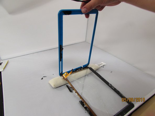

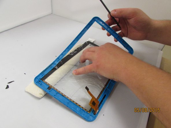

    2. Visual Land Prestige 10 Digitizer Replacement: crwdns2935265:016crwdnd2935265:01crwdnd2935265:03crwdne2935265:0 Visual Land Prestige 10 Digitizer Replacement: crwdns2935265:016crwdnd2935265:02crwdnd2935265:03crwdne2935265:0 Visual Land Prestige 10 Digitizer Replacement: crwdns2935265:016crwdnd2935265:03crwdnd2935265:03crwdne2935265:0
      • Be extremely careful removing the touchscreen, avoiding sharp glass and hot surfaces.
      • Using the heating pad, heat the edges of the touchscreen to loosen the adhesive.
      • using the spudger, slowly and gently work around the edges, removing the touchscreen.
      • The Tablet we used came with a shattered screen, making this step much more difficult.
