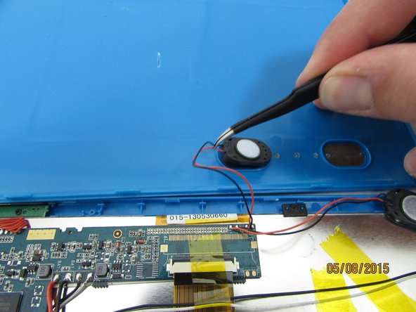

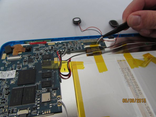

  3. Visual Land Prestige 10 Battery Replacement: crwdns2935265:03crwdnd2935265:01crwdnd2935265:03crwdne2935265:0 Visual Land Prestige 10 Battery Replacement: crwdns2935265:03crwdnd2935265:02crwdnd2935265:03crwdne2935265:0 Visual Land Prestige 10 Battery Replacement: crwdns2935265:03crwdnd2935265:03crwdnd2935265:03crwdne2935265:0
    • now that the case is open, carefully remove the speakers and set aside.

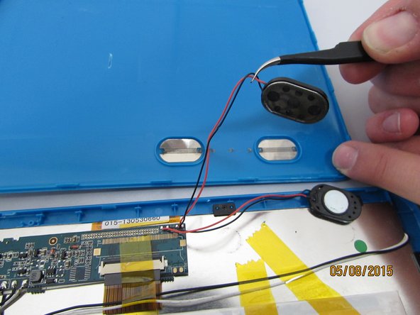

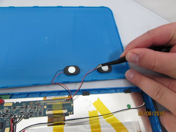

  4. Visual Land Prestige 10 Battery Replacement: crwdns2935265:04crwdnd2935265:01crwdnd2935265:02crwdne2935265:0 Visual Land Prestige 10 Battery Replacement: crwdns2935265:04crwdnd2935265:02crwdnd2935265:02crwdne2935265:0
    • Gently remove the speakers from the back case with tweezers and set the case aside.

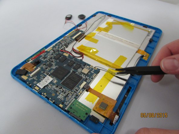

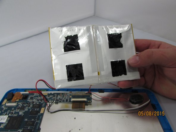

  5. Visual Land Prestige 10 Battery Replacement, Battery: crwdns2935265:05crwdnd2935265:01crwdnd2935265:03crwdne2935265:0 Visual Land Prestige 10 Battery Replacement, Battery: crwdns2935265:05crwdnd2935265:02crwdnd2935265:03crwdne2935265:0 Visual Land Prestige 10 Battery Replacement, Battery: crwdns2935265:05crwdnd2935265:03crwdnd2935265:03crwdne2935265:0
    • Remove yellow tape from surrounding components.

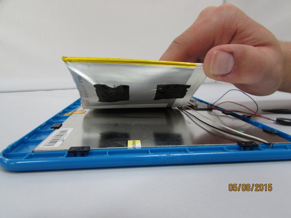

  6. Visual Land Prestige 10 Battery Replacement: crwdns2935265:06crwdnd2935265:01crwdnd2935265:03crwdne2935265:0 Visual Land Prestige 10 Battery Replacement: crwdns2935265:06crwdnd2935265:02crwdnd2935265:03crwdne2935265:0 Visual Land Prestige 10 Battery Replacement: crwdns2935265:06crwdnd2935265:03crwdnd2935265:03crwdne2935265:0
    • insert the spudger and gently work around and underneath the battery.
    • With the battery separated from the LCD Display, set it aside.
    • The battery is held down by very strong adhesive.
  7. Visual Land Prestige 10 Battery Replacement: crwdns2935265:07crwdnd2935265:01crwdnd2935265:01crwdne2935265:0
    • Desolder and remove the 2 wires from the motherboard.
    • Use caution when desoldering to avoid damage to yourself or to the components.
