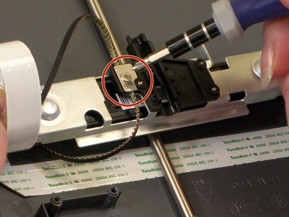

    • With the sensor bar turned upside down, remove the screw in the middle of the bar.
    • Lift off the metal plate if it does not come away with the screw.

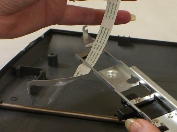

    • Carefully peel the ribbon off of the casing. The ribbon is held with two-sided tape. Use the spudger to help as needed.
    • The ribbon goes under the metal bar. Gently pull the ribbon under the metal bar to remove it.
  15. Visioneer OneTouch 7400 USB Sensor Bar Replacement: crwdns2935265:015crwdnd2935265:01crwdnd2935265:02crwdne2935265:0 Visioneer OneTouch 7400 USB Sensor Bar Replacement: crwdns2935265:015crwdnd2935265:02crwdnd2935265:02crwdne2935265:0
    • Lift the sensor bar from the scanner bed.

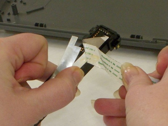

    • To finish removing the ribbon from the sensor bar, use the spudger to pry away the clear plastic piece securing the ribbon to the bar. Detach the ribbon from the sensor bar by peeling it away from the double-sided tape.
  16. Visioneer OneTouch 7400 USB Sensor Bar Replacement: crwdns2935265:016crwdnd2935265:01crwdnd2935265:01crwdne2935265:0
    • Slowly pull the ribbon end straight out to remove it from the sensor bar.
