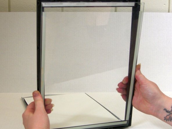

  5. Visioneer OneTouch 7400 USB Scanner Bed Replacement, Scanner Bed: crwdns2935265:05crwdnd2935265:01crwdnd2935265:01crwdne2935265:0
    • Apply even pressure against the back of the glass while securing the plastic frame in place.
  6. Visioneer OneTouch 7400 USB Scanner Bed Replacement: crwdns2935265:06crwdnd2935265:01crwdnd2935265:02crwdne2935265:0 Visioneer OneTouch 7400 USB Scanner Bed Replacement: crwdns2935265:06crwdnd2935265:02crwdnd2935265:02crwdne2935265:0
    • With consistent pressure on the glass, move your fingers down the sides until the glass is no longer stuck to the double-sided tape.
