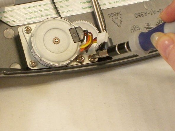

  6. Visioneer OneTouch 7400 USB Motor Replacement: crwdns2935265:06crwdnd2935265:01crwdnd2935265:02crwdne2935265:0 Visioneer OneTouch 7400 USB Motor Replacement: crwdns2935265:06crwdnd2935265:02crwdnd2935265:02crwdne2935265:0
    • Remove the four screws holding the motor in place.
    • Note: the pictures hereafter shown are without the motherboard, but you do not have to remove the motherboard to access the motor.
