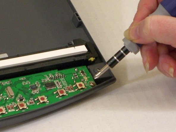

  5. Visioneer OneTouch 7400 USB Motherboard Replacement, Motherboard: crwdns2935265:05crwdnd2935265:01crwdnd2935265:02crwdne2935265:0 Visioneer OneTouch 7400 USB Motherboard Replacement, Motherboard: crwdns2935265:05crwdnd2935265:02crwdnd2935265:02crwdne2935265:0
    • On the bottom half of the casing, remove the two screws in the motherboard.
