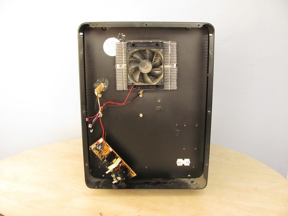

  2. Vinotemp VT-12TEDi Motherboard Repair: crwdns2935265:02crwdnd2935265:01crwdnd2935265:01crwdne2935265:0
    • Power Cord Fastener
    • Ground
    • Motherboard
    • Heat Sink Fan
    • Heat Sink

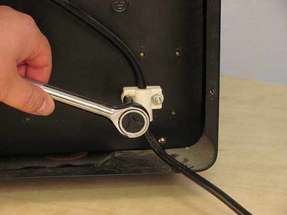

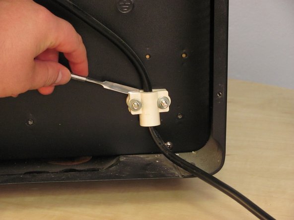

    • Remove two 7mm Hex Nuts.
    • Clearance is minimal and these screws are very tight. You will likely need a socket wrench to avoid stripping.
    • If the white plastic components stick, pry them apart with a metal spudger. Don't pull on the power cord to get plastic pieces to separate.

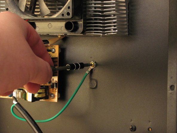

    • Remove one 12mm Phillips screw securing ground.

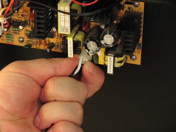

    • Remove power cable from motherboard.
    • Pinch cable connector to release it from the motherboard, then pull.

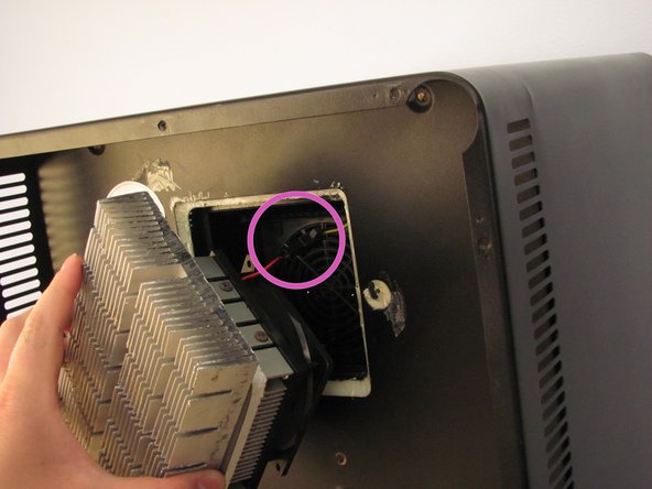

    • Remove heat sink slowly to avoid breaking cold sink fan cable.
    • Disconnect cold sink fan cable.
