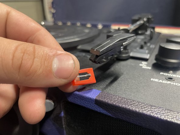

    • Open your record player.
  2. Victrola Journey Stylus Replacement: crwdns2935265:02crwdnd2935265:01crwdnd2935265:03crwdne2935265:0 Victrola Journey Stylus Replacement: crwdns2935265:02crwdnd2935265:02crwdnd2935265:03crwdne2935265:0 Victrola Journey Stylus Replacement: crwdns2935265:02crwdnd2935265:03crwdnd2935265:03crwdne2935265:0
    • Carefully pry off the old stylus with a flat head screwdriver.
    • The stylus should hinge away from you.
  3. Victrola Journey Stylus Replacement: crwdns2935265:03crwdnd2935265:01crwdnd2935265:02crwdne2935265:0 Victrola Journey Stylus Replacement: crwdns2935265:03crwdnd2935265:02crwdnd2935265:02crwdne2935265:0
    • Remove the new stylus from its packaging.
    • Be careful to not bend the needle.

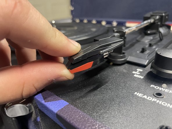

  4. Victrola Journey Stylus Replacement: crwdns2935265:04crwdnd2935265:01crwdnd2935265:02crwdne2935265:0 Victrola Journey Stylus Replacement: crwdns2935265:04crwdnd2935265:02crwdnd2935265:02crwdne2935265:0
    • Place the new stylus onto the arm hinging from the back to the front.
    • You should hear the plastic "snap" into place.
  5. Victrola Journey Stylus Replacement: crwdns2935265:05crwdnd2935265:01crwdnd2935265:01crwdne2935265:0
    • After this you should be done! The last step is to take out that record you've been wanting to hear and start jamming out!
