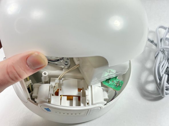

      • Ensure the device is clear of water before disassembling.
      • Orient the device so the nozzle is facing the ceiling.
      • Twist off the primary water holding cap.
    2. Vicks FilterFree Plus Fan Replacement: crwdns2935265:02crwdnd2935265:01crwdnd2935265:02crwdne2935265:0 Vicks FilterFree Plus Fan Replacement: crwdns2935265:02crwdnd2935265:02crwdnd2935265:02crwdne2935265:0
      • Place the device upside down so that the tank cap is facing you.
      • Use your hands to twist the tank cap and remove it from the device.

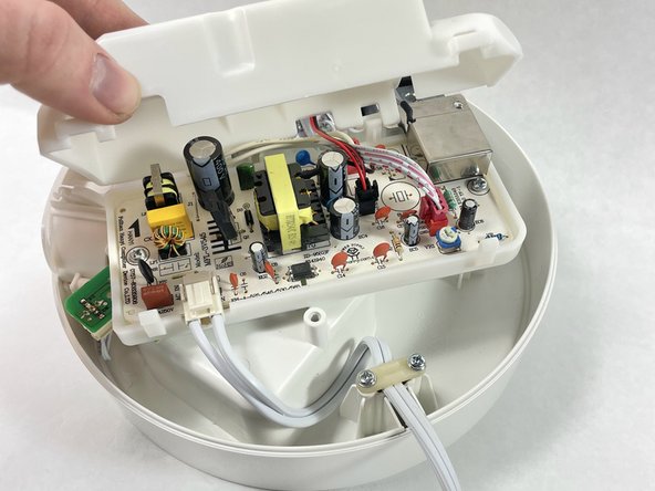

      • Remove the three screws from the base of the device using a T20 Torx screwdriver.
      • Remove the base of the humidifier to access the components.
    2. Vicks FilterFree Plus Fan Replacement: crwdns2935265:04crwdnd2935265:01crwdnd2935265:02crwdne2935265:0 Vicks FilterFree Plus Fan Replacement: crwdns2935265:04crwdnd2935265:02crwdnd2935265:02crwdne2935265:0

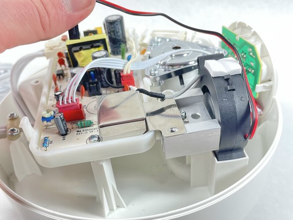

      • Gently remove the inner shield for the primary board to access the wiring for the humidifier.
    3. Vicks FilterFree Plus Fan Replacement: crwdns2935265:05crwdnd2935265:01crwdnd2935265:03crwdne2935265:0 Vicks FilterFree Plus Fan Replacement: crwdns2935265:05crwdnd2935265:02crwdnd2935265:03crwdne2935265:0 Vicks FilterFree Plus Fan Replacement: crwdns2935265:05crwdnd2935265:03crwdnd2935265:03crwdne2935265:0

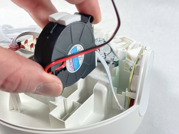

      • Remove the fan by disconnecting its wire from the board.
      • Gently remove the fan from the device.
