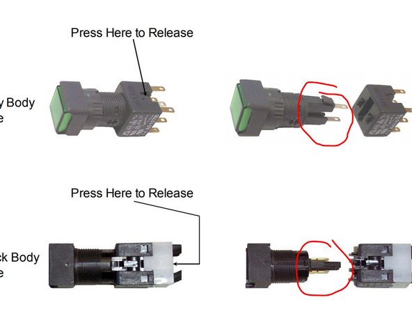

  4. VersaMed iVent 201 O2 Pressure Switch Replacement, O2 Pressure Switch: crwdns2935265:010crwdnd2935265:01crwdnd2935265:01crwdne2935265:0
    • Turn the unit off and disassemble the front enclosure (previous steps).
  5. VersaMed iVent 201 O2 Pressure Switch Replacement: crwdns2935265:011crwdnd2935265:01crwdnd2935265:01crwdne2935265:0
    • For the silver colored metal on the O2 inlet pipe, connect the ohmmeter to Pins 1 and 2 (red wire and white wire).
  6. VersaMed iVent 201 O2 Pressure Switch Replacement: crwdns2935265:012crwdnd2935265:01crwdnd2935265:02crwdne2935265:0 VersaMed iVent 201 O2 Pressure Switch Replacement: crwdns2935265:012crwdnd2935265:02crwdnd2935265:02crwdne2935265:0
    • For the brass colored metal located on the back wall of the rear enclosure, connect the ohmmeter to the two tabs located on the back of the switch body.
    • After connecting an ohmmeter to the terminals, measure the switch state. The switch is normally open when there is no O2 present and should short with the presence with a high pressure of O2.
  7. VersaMed iVent 201 O2 Pressure Switch Replacement: crwdns2935265:014crwdnd2935265:01crwdnd2935265:01crwdne2935265:0
    • Switch terminals are connected to pins 9 and 17 shown, regardless of the O2 pressure switch type.
