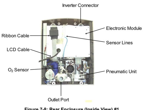

    • Disconnect the three tubes from the barbed fittings along the bottom of the inside of the front enclosure. Be sure to note where they were connected.
  3. VersaMed iVent 201 Electronic Module Replacement, Enclosure Disassembly 5: crwdns2935265:06crwdnd2935265:01crwdnd2935265:02crwdne2935265:0 VersaMed iVent 201 Electronic Module Replacement, Enclosure Disassembly 5: crwdns2935265:06crwdnd2935265:02crwdnd2935265:02crwdne2935265:0
    • Disconnect the ribbon cable from the interface PC board located in the middle of the front enclosure.
    • Disconnect the green ground wire and receptacle from the pneumatic unit (just above the outlet port).
    • Disconnect the inverter cable from the top of the electronic module.

    • Position the front enclosure standing up so that it is approximately 4 inches from the rear enclosure.
    • Connect the inverter cable to the top of the electronic module.
    • Connect the ribbon cable (from the bottom of the electronic module) to the interface PC board located in the middle of the front enclosure. Verify that the connector's side retaining clips are snapped into place.
    • Connect the ground cable to the spade terminal located just above the outlet port.
    • Connect the three (3) tubes to the barbed fittings located along the bottom of the inside of the front enclosure. Be sure to reconnect them to the same locations that they were removed from:
    • The tube from the outlet port tee is connected to the left-most fitting (when viewed from the inside).
    • The blue tube (or tube with a blue stripe) is connected to the right- most fitting.
    • The remaining tube is connected to the last remaining fitting
