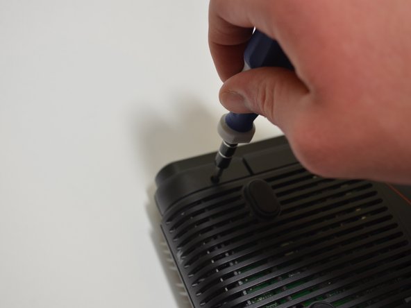

    • Unscrew the five 10-mm screws on the bottom of the router using a Phillips #0 screwdriver.

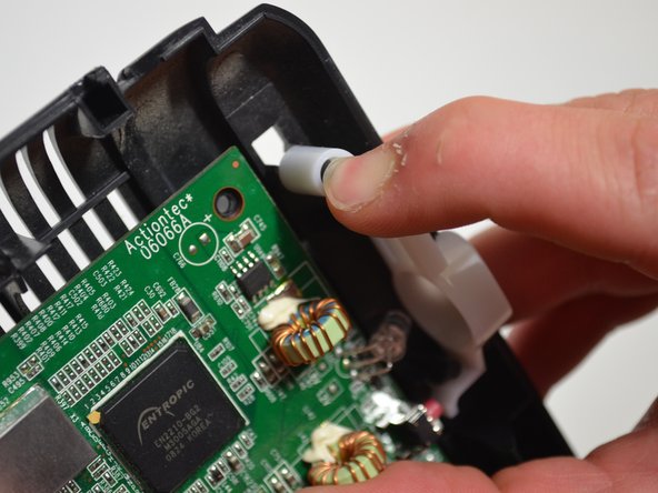

    • Locate the refresh button.

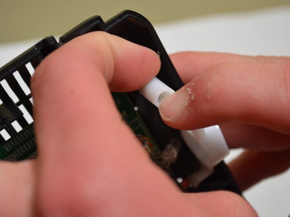

  6. Verizon M1424WR Refresh Button Replacement: crwdns2935265:06crwdnd2935265:01crwdnd2935265:03crwdne2935265:0 Verizon M1424WR Refresh Button Replacement: crwdns2935265:06crwdnd2935265:02crwdnd2935265:03crwdne2935265:0 Verizon M1424WR Refresh Button Replacement: crwdns2935265:06crwdnd2935265:03crwdnd2935265:03crwdne2935265:0
    • Apply pressure with your finger to the black tab that retains the refresh button while using your other hand to pull the bottom of the refresh button from the post.
