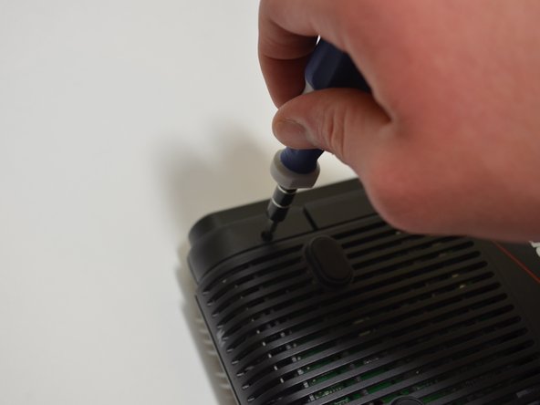

    • Unscrew the five 10-mm screws on the bottom of the router using a Phillips #0 screwdriver.

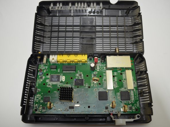

    • Use a plastic-opening tool and pry the top casing from the bottom casing to expose the circuit board in the bottom half of the device.

    • Locate the two 10-mm screws on either side of the circuit board.
    • Unscrew the two 10-mm screws using a Phillips #0 screwdriver.
    • Keep track of the red rubber washer you remove from underneath one of the screws.
  6. Verizon M1424WR Motherboard Replacement: crwdns2935265:06crwdnd2935265:01crwdnd2935265:01crwdne2935265:0
    • Lift the front of the circuit board up from the bottom casing.
  7. Verizon M1424WR Motherboard Replacement: crwdns2935265:07crwdnd2935265:01crwdnd2935265:01crwdne2935265:0
    • Pull the circuit board towards you until it is separate from the bottom casing.
