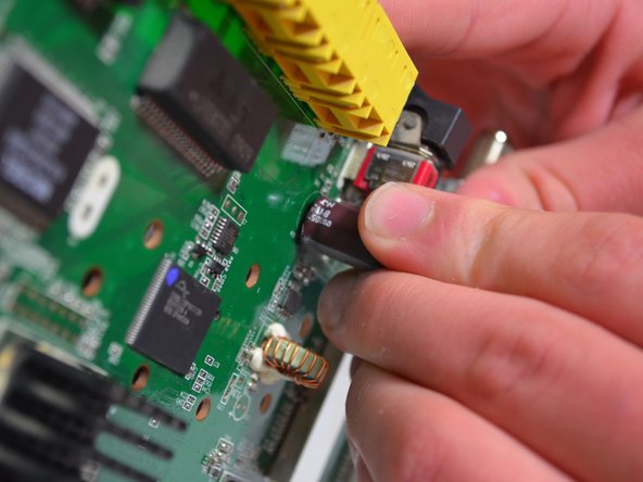

  8. Verizon M1424WR Capacitor Replacement, Capacitor: crwdns2935265:08crwdnd2935265:01crwdnd2935265:01crwdne2935265:0
    • Locate the capacitor.
  9. Verizon M1424WR Capacitor Replacement: crwdns2935265:09crwdnd2935265:01crwdnd2935265:01crwdne2935265:0
    • Flip the circuit board over.
    • Locate the two prongs on the flip side that are attached to the capacitor on the top side.

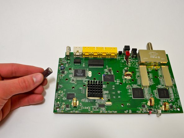

  10. Verizon M1424WR Capacitor Replacement: crwdns2935265:010crwdnd2935265:01crwdnd2935265:03crwdne2935265:0 Verizon M1424WR Capacitor Replacement: crwdns2935265:010crwdnd2935265:02crwdnd2935265:03crwdne2935265:0 Verizon M1424WR Capacitor Replacement: crwdns2935265:010crwdnd2935265:03crwdnd2935265:03crwdne2935265:0
    • Touch the hot soldering iron to each prong in order to melt the solder around them.
    • Flip the circuit board and pull out the capacitor from its place while the solder is still hot.
    • For help with soldering techniques, click here.
  11. Verizon M1424WR Capacitor Replacement, Reassembly: crwdns2935265:011crwdnd2935265:01crwdnd2935265:03crwdne2935265:0 Verizon M1424WR Capacitor Replacement, Reassembly: crwdns2935265:011crwdnd2935265:02crwdnd2935265:03crwdne2935265:0 Verizon M1424WR Capacitor Replacement, Reassembly: crwdns2935265:011crwdnd2935265:03crwdnd2935265:03crwdne2935265:0
    • Insert the new capacitor through the circuit board so that the prongs are exposed on the flip side.
    • Heat the prongs up with the soldering iron and touch a soldering wire to the hot prongs to attach the capacitor to the board.
