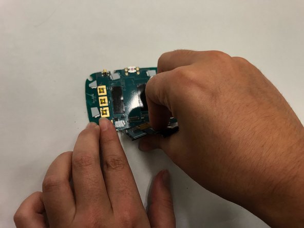

    • Using the metal spudger, gently pull out the motherboard from the plastic casing.
  8. Verizon Jetpack 4G LTE Mobile Hotspot Buttons Replacement: crwdns2935265:08crwdnd2935265:01crwdnd2935265:03crwdne2935265:0 Verizon Jetpack 4G LTE Mobile Hotspot Buttons Replacement: crwdns2935265:08crwdnd2935265:02crwdnd2935265:03crwdne2935265:0 Verizon Jetpack 4G LTE Mobile Hotspot Buttons Replacement: crwdns2935265:08crwdnd2935265:03crwdnd2935265:03crwdne2935265:0

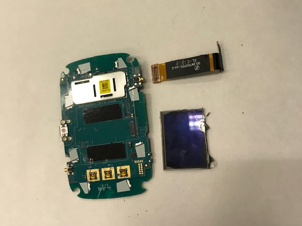

    • Rotate the motherboard so that the screen is facing you.
    • Gently pull up the orange tape to remove the screen.
  9. Verizon Jetpack 4G LTE Mobile Hotspot Buttons Replacement, Buttons: crwdns2935265:09crwdnd2935265:01crwdnd2935265:03crwdne2935265:0 Verizon Jetpack 4G LTE Mobile Hotspot Buttons Replacement, Buttons: crwdns2935265:09crwdnd2935265:02crwdnd2935265:03crwdne2935265:0 Verizon Jetpack 4G LTE Mobile Hotspot Buttons Replacement, Buttons: crwdns2935265:09crwdnd2935265:03crwdnd2935265:03crwdne2935265:0
    • Now that the motherboard is out, the buttons should come easily out of what's left of the device. If they do not fall out once the motherboard is out, simply poke the buttons from the front and they should separate from the device.
