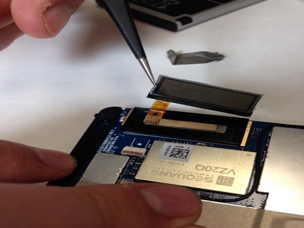

    1. Verizon Ellipsis Jetpack MHS800L Screen Replacement, Screen: crwdns2935265:010crwdnd2935265:01crwdnd2935265:03crwdne2935265:0 Verizon Ellipsis Jetpack MHS800L Screen Replacement, Screen: crwdns2935265:010crwdnd2935265:02crwdnd2935265:03crwdne2935265:0 Verizon Ellipsis Jetpack MHS800L Screen Replacement, Screen: crwdns2935265:010crwdnd2935265:03crwdnd2935265:03crwdne2935265:0
      • Locate the LCD screen cable and unlatch the harness connection form the circuit board.
    2. Verizon Ellipsis Jetpack MHS800L Screen Replacement: crwdns2935265:011crwdnd2935265:01crwdnd2935265:02crwdne2935265:0 Verizon Ellipsis Jetpack MHS800L Screen Replacement: crwdns2935265:011crwdnd2935265:02crwdnd2935265:02crwdne2935265:0
      • Using the Tweezers gently coax the display data cable out of circuit board connector.
      • Do not squeeze the display data cable to hard you may damage it and cause a short.
    3. Verizon Ellipsis Jetpack MHS800L Screen Replacement: crwdns2935265:012crwdnd2935265:01crwdnd2935265:02crwdne2935265:0 Verizon Ellipsis Jetpack MHS800L Screen Replacement: crwdns2935265:012crwdnd2935265:02crwdnd2935265:02crwdne2935265:0
      • Gently insert the Tweezers underneath the LCD screen and lift the LCD screen off of the circuit board.
