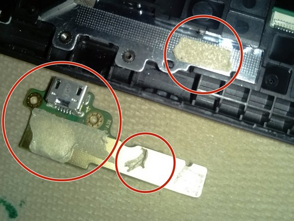

      • Be careful when removing the ribbon cables as there is adhesive on the back of them. To remove the cables flip up the rear part of the connector to slide the cable out - *gently*.
      • The USB Charging Connector and the Antenna Board both have adhesive on the back. Remove the screws and carefully lift up on the boards to remove them.

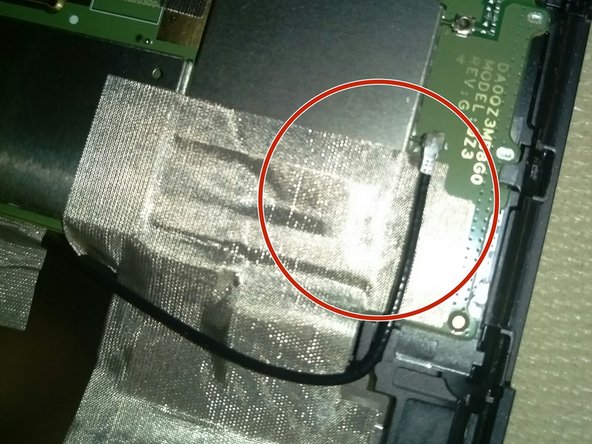

      • **Be careful with the antenna cable!**
