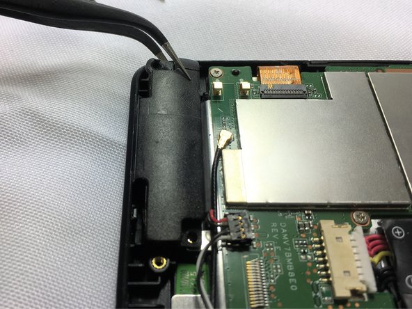

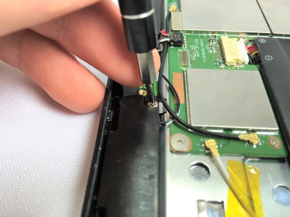

  5. Verizon Ellipsis 7 Speaker Replacement, Speaker: crwdns2935265:05crwdnd2935265:01crwdnd2935265:02crwdne2935265:0 Verizon Ellipsis 7 Speaker Replacement, Speaker: crwdns2935265:05crwdnd2935265:02crwdnd2935265:02crwdne2935265:0
    • Remove 2 screws from each speaker, 4 screws in total, using a Phillips #00 screwdriver.
    • The screws shown in the picture are the more common 4.76 mm.

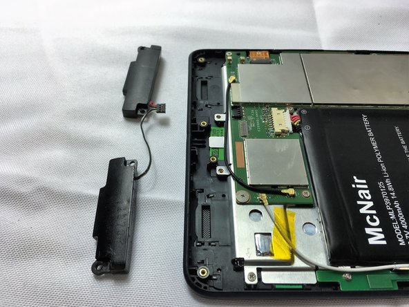

  6. Verizon Ellipsis 7 Speaker Replacement: crwdns2935265:06crwdnd2935265:01crwdnd2935265:03crwdne2935265:0 Verizon Ellipsis 7 Speaker Replacement: crwdns2935265:06crwdnd2935265:02crwdnd2935265:03crwdne2935265:0 Verizon Ellipsis 7 Speaker Replacement: crwdns2935265:06crwdnd2935265:03crwdnd2935265:03crwdne2935265:0
    • Using tweezers carefully lift the connector up to disconnect it from the motherboard.
    • Using tweezers carefully pull the speakers up and out of device.
