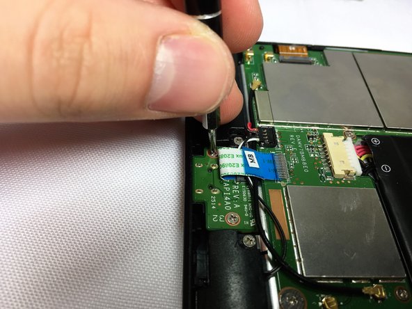

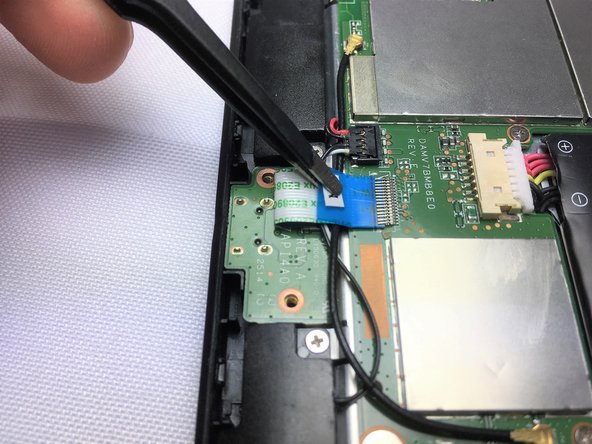

  3. Verizon Ellipsis 7 Power Button Replacement: crwdns2935265:03crwdnd2935265:01crwdnd2935265:03crwdne2935265:0 Verizon Ellipsis 7 Power Button Replacement: crwdns2935265:03crwdnd2935265:02crwdnd2935265:03crwdne2935265:0 Verizon Ellipsis 7 Power Button Replacement: crwdns2935265:03crwdnd2935265:03crwdnd2935265:03crwdne2935265:0
    • Remove the charging (micro-USB) port by unscrewing the indicated screws using the Phillips #00 screwdriver.
    • Disconnect the ribbon cable connecting the charging port board to the motherboard using tweezers.
    • Use the tweezers to grab the sides of black, plastic connector. Do not grab from the wires or try to wedge it out from the bottom.
    • Be extremely careful when disconnecting the ribbon cable. It is very delicate.

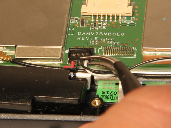

    • Disconnect speakers from motherboard.
    • Use the tweezers to carefully disconnect speakers from motherboard.

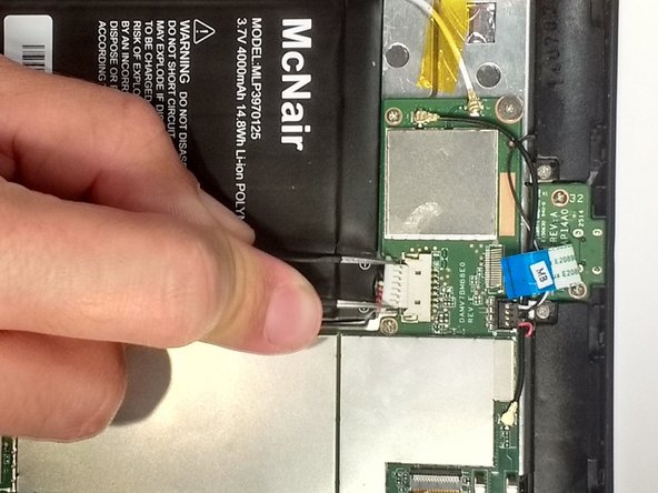

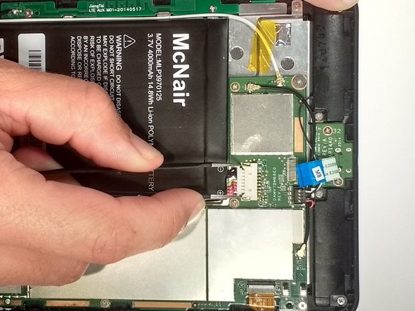

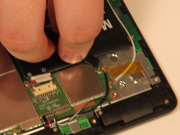

  5. Verizon Ellipsis 7 Power Button Replacement: crwdns2935265:05crwdnd2935265:01crwdnd2935265:03crwdne2935265:0 Verizon Ellipsis 7 Power Button Replacement: crwdns2935265:05crwdnd2935265:02crwdnd2935265:03crwdne2935265:0 Verizon Ellipsis 7 Power Button Replacement: crwdns2935265:05crwdnd2935265:03crwdnd2935265:03crwdne2935265:0
    • Disconnect the battery.
    • Use tweezers to carefully disengage connector.

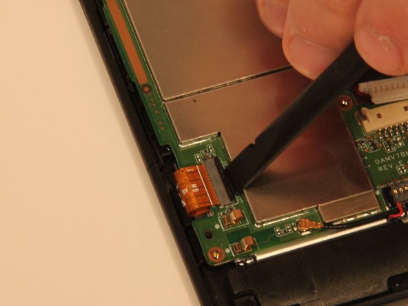

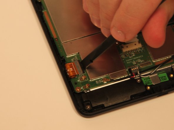

  6. Verizon Ellipsis 7 Power Button Replacement: crwdns2935265:06crwdnd2935265:01crwdnd2935265:03crwdne2935265:0 Verizon Ellipsis 7 Power Button Replacement: crwdns2935265:06crwdnd2935265:02crwdnd2935265:03crwdne2935265:0 Verizon Ellipsis 7 Power Button Replacement: crwdns2935265:06crwdnd2935265:03crwdnd2935265:03crwdne2935265:0
    • Disconnect the digitizer ribbon cable.
    • Use a nylon spudger to lift back tab.
    • After the back tab has been lifted the cable can be removed with tweezers.
    • When using tweezers, be careful not to damage the ribbon cable.

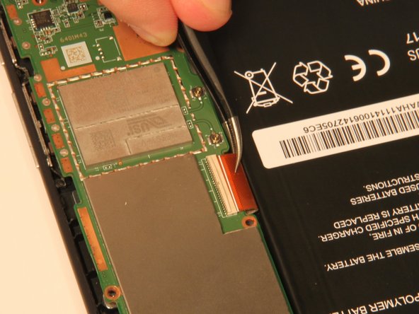

  7. Verizon Ellipsis 7 Power Button Replacement: crwdns2935265:07crwdnd2935265:01crwdnd2935265:03crwdne2935265:0 Verizon Ellipsis 7 Power Button Replacement: crwdns2935265:07crwdnd2935265:02crwdnd2935265:03crwdne2935265:0 Verizon Ellipsis 7 Power Button Replacement: crwdns2935265:07crwdnd2935265:03crwdnd2935265:03crwdne2935265:0
    • Disconnect the ribbon cable.
    • Use a nylon spudger to lift tab.
    • After the tab is lifted, the cable can be removed.

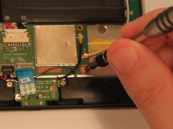

  8. Verizon Ellipsis 7 Power Button Replacement: crwdns2935265:08crwdnd2935265:01crwdnd2935265:03crwdne2935265:0 Verizon Ellipsis 7 Power Button Replacement: crwdns2935265:08crwdnd2935265:02crwdnd2935265:03crwdne2935265:0 Verizon Ellipsis 7 Power Button Replacement: crwdns2935265:08crwdnd2935265:03crwdnd2935265:03crwdne2935265:0
    • Disconnect all antenna cables.
    • Use a nylon spudger to pop the antenna cable from the base.

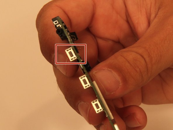

  10. Verizon Ellipsis 7 Power Button Replacement: crwdns2935265:010crwdnd2935265:01crwdnd2935265:02crwdne2935265:0 Verizon Ellipsis 7 Power Button Replacement: crwdns2935265:010crwdnd2935265:02crwdnd2935265:02crwdne2935265:0
    • Remove the motherboard.
    • Locate power button.

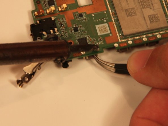

  11. Verizon Ellipsis 7 Power Button Replacement: crwdns2935265:011crwdnd2935265:01crwdnd2935265:02crwdne2935265:0 Verizon Ellipsis 7 Power Button Replacement: crwdns2935265:011crwdnd2935265:02crwdnd2935265:02crwdne2935265:0
    • Desolder the power button from the motherboard.
    • Learn how to solder and desolder components here!
