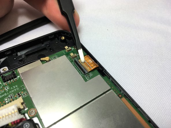

  3. Verizon Ellipsis 7 Front Facing Camera Replacement: crwdns2935265:03crwdnd2935265:01crwdnd2935265:03crwdne2935265:0 Verizon Ellipsis 7 Front Facing Camera Replacement: crwdns2935265:03crwdnd2935265:02crwdnd2935265:03crwdne2935265:0 Verizon Ellipsis 7 Front Facing Camera Replacement: crwdns2935265:03crwdnd2935265:03crwdnd2935265:03crwdne2935265:0
    • Remove the charging (micro-USB) port.
    • Unscrew the indicated screws using the Phillips #00 screwdriver.
    • The screws shown in the picture are the more common 4.76 mm.
    • Disconnect the ribbon cable connecting the charging port board to the motherboard using tweezers.
    • Use the tweezers to grab the sides of black, plastic connector. Do not grab from the wires or try to wedge it out from the bottom.
    • Be extremely careful when disconnecting the ribbon cable. It is very delicate.

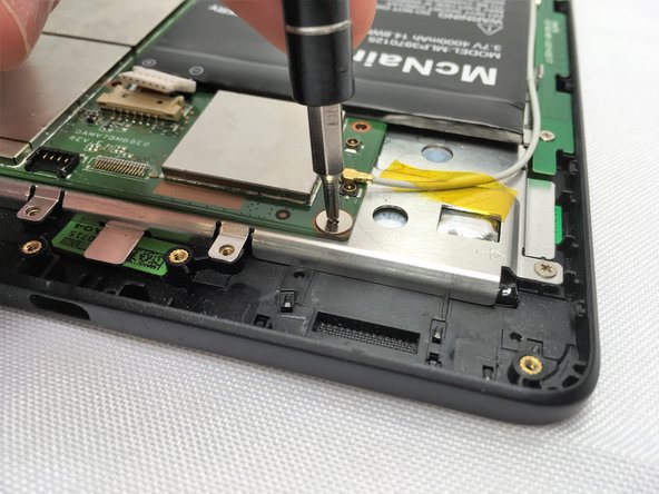

  8. Verizon Ellipsis 7 Front Facing Camera Replacement: crwdns2935265:08crwdnd2935265:01crwdnd2935265:02crwdne2935265:0 Verizon Ellipsis 7 Front Facing Camera Replacement: crwdns2935265:08crwdnd2935265:02crwdnd2935265:02crwdne2935265:0
    • Remove the 10 screws from the motherboard using a Phillips #0 screwdriver.
    • The screws shown in the first picture is the more common 4.76 mm.
    • The screw shown in the second picture is shorter than the rest of the screws: 3.175 mm.

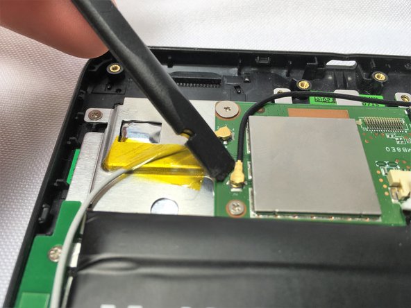

  9. Verizon Ellipsis 7 Front Facing Camera Replacement: crwdns2935265:09crwdnd2935265:01crwdnd2935265:02crwdne2935265:0 Verizon Ellipsis 7 Front Facing Camera Replacement: crwdns2935265:09crwdnd2935265:02crwdnd2935265:02crwdne2935265:0
    • Using a spudger, remove the 5 antenna cable connectors from the motherboard.

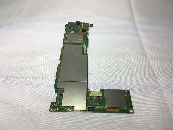

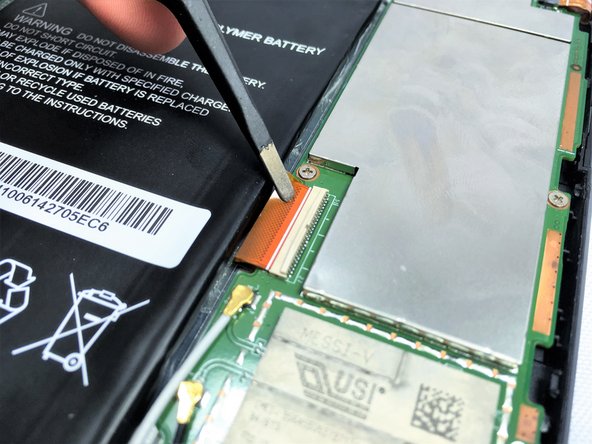

  10. Verizon Ellipsis 7 Front Facing Camera Replacement: crwdns2935265:010crwdnd2935265:01crwdnd2935265:03crwdne2935265:0 Verizon Ellipsis 7 Front Facing Camera Replacement: crwdns2935265:010crwdnd2935265:02crwdnd2935265:03crwdne2935265:0 Verizon Ellipsis 7 Front Facing Camera Replacement: crwdns2935265:010crwdnd2935265:03crwdnd2935265:03crwdne2935265:0
    • Disconnect the two ZIF connectors that are connected to the motherboard with the spudger. Lift up the metal part of the connector and pull it off of its port
    • Once disconnected from the port, pull the metal part away from its connector carefully with the tweezers.
    • When all the connectors have been disconnected, you can gently lift the motherboard from the device.

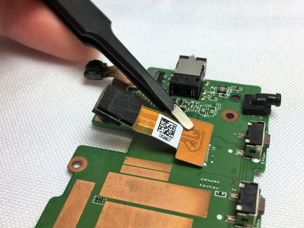

  11. Verizon Ellipsis 7 Front Facing Camera Replacement: crwdns2935265:011crwdnd2935265:01crwdnd2935265:03crwdne2935265:0 Verizon Ellipsis 7 Front Facing Camera Replacement: crwdns2935265:011crwdnd2935265:02crwdnd2935265:03crwdne2935265:0 Verizon Ellipsis 7 Front Facing Camera Replacement: crwdns2935265:011crwdnd2935265:03crwdnd2935265:03crwdne2935265:0
    • Make sure the press lift connector is disconnected using the spudger, then carefully flip the motherboard over.
    • Disconnect the camera in the middle of the board using tweezers.
