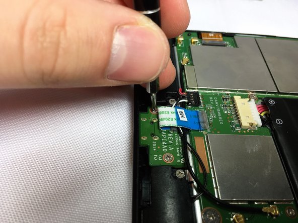

    • Remove the charging (micro-USB) port.
    • Unscrew the indicated screws using the Phillips #00 screwdriver.
    • The screws shown in the picture are the more common 4.76 mm.

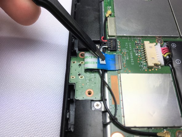

    • Disconnect the ribbon cable connecting the charging port board to the motherboard using tweezers.
    • Use the tweezers to grab the sides of black, plastic connector. Do not grab from the wires or try to wedge it out from the bottom.
    • Be extremely careful when disconnecting the ribbon cable. It is very delicate.
