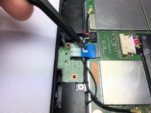

  3. Verizon Ellipsis 7 Battery Replacement: crwdns2935265:03crwdnd2935265:01crwdnd2935265:03crwdne2935265:0 Verizon Ellipsis 7 Battery Replacement: crwdns2935265:03crwdnd2935265:02crwdnd2935265:03crwdne2935265:0 Verizon Ellipsis 7 Battery Replacement: crwdns2935265:03crwdnd2935265:03crwdnd2935265:03crwdne2935265:0
    • Remove the charging (micro-USB) port by unscrewing the indicated screws using the Phillips #00 screwdriver.
    • Disconnect the ribbon cable connecting the charging port board to the motherboard using tweezers.
    • Use the tweezers to grab the sides of black, plastic connector. Do not grab from the wires or try to wedge it out from the bottom.
    • Be extremely careful when disconnecting the ribbon cable. It is very delicate.

so much for the charging port. You didn’t mention the battery. ?
good1946scout - crwdns2934203:0crwdne2934203:0
Well….ok…..but were we here for removing the charging port? Ha ha….I think not. So how about we lift out the battery and unplug it instead. Takes a bit of effort , it seems. That sucker is stuck down pretty good with some really good double sided tape. Lift carefully. I pried it up with the same plastic case tool I used to remove the back cover. The same tool also helped me remove the battery plug.
