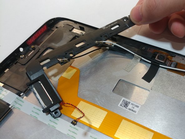

    4. Verizon Ellipsis 10 Camera Replacement: crwdns2935265:013crwdnd2935265:01crwdnd2935265:01crwdne2935265:0
      • Use a pair of tweezers to lift up the front camera off its locating post.

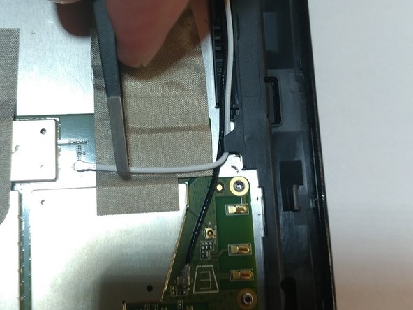

    5. Verizon Ellipsis 10 Camera Replacement: crwdns2935265:014crwdnd2935265:01crwdnd2935265:02crwdne2935265:0 Verizon Ellipsis 10 Camera Replacement: crwdns2935265:014crwdnd2935265:02crwdnd2935265:02crwdne2935265:0
      • Remove the non-conductive tape covering the camera ribbon cable.
      • You may need to remove the white antenna cable to remove the tape.

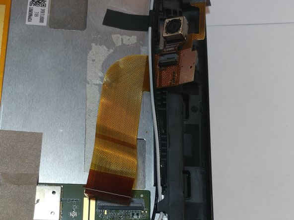

    6. Verizon Ellipsis 10 Camera Replacement: crwdns2935265:015crwdnd2935265:01crwdnd2935265:01crwdne2935265:0
      • Carefully unplug the ribbon cable from the motherboard.
    7. Verizon Ellipsis 10 Camera Replacement: crwdns2935265:016crwdnd2935265:01crwdnd2935265:02crwdne2935265:0 Verizon Ellipsis 10 Camera Replacement: crwdns2935265:016crwdnd2935265:02crwdnd2935265:02crwdne2935265:0
      • Peel up the ribbon cable carefully as it is glued to the device.
      • After having peeled up the cable, the cameras should be free to come out of the device.
