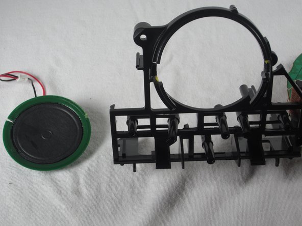

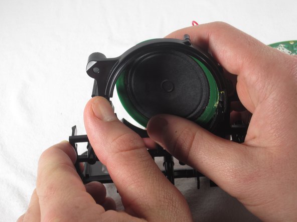

  9. Venturer CR20 Speaker Replacement, Speaker: crwdns2935265:09crwdnd2935265:01crwdnd2935265:03crwdne2935265:0 Venturer CR20 Speaker Replacement, Speaker: crwdns2935265:09crwdnd2935265:02crwdnd2935265:03crwdne2935265:0 Venturer CR20 Speaker Replacement, Speaker: crwdns2935265:09crwdnd2935265:03crwdnd2935265:03crwdne2935265:0
    • Flip over the motherboard and grab hold of the plastic frame.
    • With a small amount of force, push on the plastic clips, away from you, to eject the speaker from its plastic housing.
