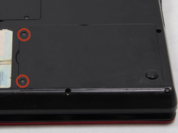

  3. Velocity NoteMagix M10 A82 Hard Drive Replacement, Hard Drive: crwdns2935265:03crwdnd2935265:01crwdnd2935265:02crwdne2935265:0 Velocity NoteMagix M10 A82 Hard Drive Replacement, Hard Drive: crwdns2935265:03crwdnd2935265:02crwdnd2935265:02crwdne2935265:0
    • Unscrew the two 3.65mm Phillips #1 screws on the plate marked "HDD".

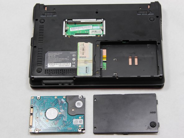

  4. Velocity NoteMagix M10 A82 Hard Drive Replacement: crwdns2935265:04crwdnd2935265:01crwdnd2935265:01crwdne2935265:0
    • Lift the HDD plate off of the back to reveal the hard drive.
  5. Velocity NoteMagix M10 A82 Hard Drive Replacement: crwdns2935265:05crwdnd2935265:01crwdnd2935265:02crwdne2935265:0 Velocity NoteMagix M10 A82 Hard Drive Replacement: crwdns2935265:05crwdnd2935265:02crwdnd2935265:02crwdne2935265:0
    • Use the spudger to push the area above the connector on the hard drive to the right.
    • Lift the hard drive gently from the computer with the spudger.
