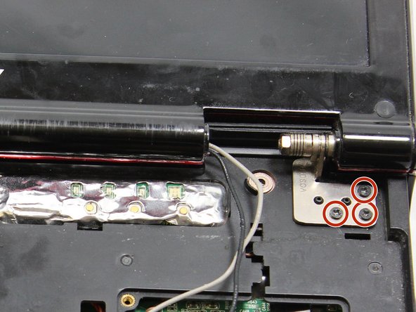

    • Place the computer open and with the screen facing up on the table.
    • Remove the three 3.65mm Phillips #1 screws in the right hand corner. Also remove the mirrored set of screws on the left side.

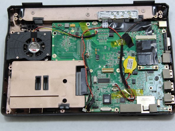

  8. Velocity NoteMagix M10 A82 Cooling Fan Replacement: crwdns2935265:08crwdnd2935265:01crwdnd2935265:01crwdne2935265:0
    • Remove the black and gray wires by gently grasping the wires where they connect to the motherboard and pulling up.
  9. Velocity NoteMagix M10 A82 Cooling Fan Replacement: crwdns2935265:09crwdnd2935265:01crwdnd2935265:01crwdne2935265:0
    • Using the plastic opening tool, pry the base of the cable connecting the screen to the motherboard upwards.

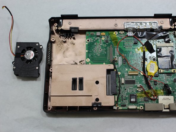

  11. Velocity NoteMagix M10 A82 Cooling Fan Replacement: crwdns2935265:011crwdnd2935265:01crwdnd2935265:01crwdne2935265:0
    • Remove the two 4.80mm Phillips #00 screws holding down the fan.
  12. Velocity NoteMagix M10 A82 Cooling Fan Replacement: crwdns2935265:012crwdnd2935265:01crwdnd2935265:02crwdne2935265:0 Velocity NoteMagix M10 A82 Cooling Fan Replacement: crwdns2935265:012crwdnd2935265:02crwdnd2935265:02crwdne2935265:0
    • Remove the red, yellow, and black wires connecting the fan to the motherboard by placing your index finger underneath the wires where they connect to the motherboard, pinching the wires together with your thumb and index finger, and gently pulling the wires upwards.
