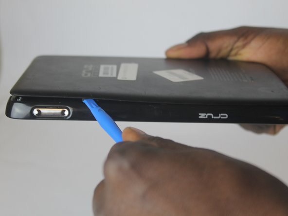

    • Insert the larger plastic opening tool in the SD port. The edge point should be pointed towards the rear panel.
  2. Velocity Micro Tablet T301 Screen Display. Replacement: crwdns2935265:02crwdnd2935265:01crwdnd2935265:01crwdne2935265:0
    • Insert a small opening tool between the rear panel and the tablet.
  3. Velocity Micro Tablet T301 Screen Display. Replacement: crwdns2935265:03crwdnd2935265:01crwdnd2935265:01crwdne2935265:0
    • The large opening tool can now be removed, leaving only the small opening tool in place.
  4. Velocity Micro Tablet T301 Screen Display. Replacement: crwdns2935265:04crwdnd2935265:01crwdnd2935265:02crwdne2935265:0 Velocity Micro Tablet T301 Screen Display. Replacement: crwdns2935265:04crwdnd2935265:02crwdnd2935265:02crwdne2935265:0
    • Slide the small opening tool along the seam of the rear panel to fully remove it.

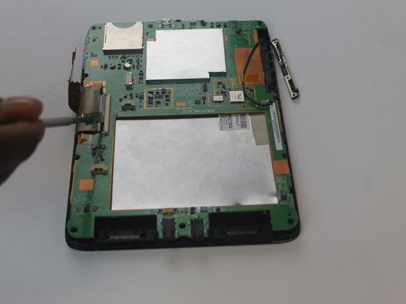

  11. Velocity Micro Tablet T301 Screen Display. Replacement: crwdns2935265:011crwdnd2935265:01crwdnd2935265:01crwdne2935265:0
    • Using a metal spudger, remove the top plug connector from the motherboard.
  12. Velocity Micro Tablet T301 Screen Display. Replacement: crwdns2935265:012crwdnd2935265:01crwdnd2935265:02crwdne2935265:0 Velocity Micro Tablet T301 Screen Display. Replacement: crwdns2935265:012crwdnd2935265:02crwdnd2935265:02crwdne2935265:0
    • Use a metal spudger to remove both screen cable connectors.
  13. Velocity Micro Tablet T301 Screen Display. Replacement: crwdns2935265:013crwdnd2935265:01crwdnd2935265:01crwdne2935265:0
    • Use opening tools to remove the motherboard.
  14. Velocity Micro Tablet T301 Screen Display. Replacement: crwdns2935265:014crwdnd2935265:01crwdnd2935265:01crwdne2935265:0
    • Remove the motherboard cover to access the screen display.
