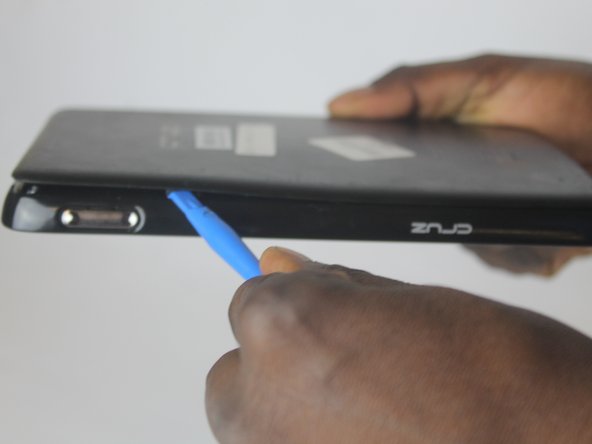

    • Insert an opening tool in the SD port, with the edge pointing towards the rear panel.
    • Use the opening tool to pry the back plate up.
