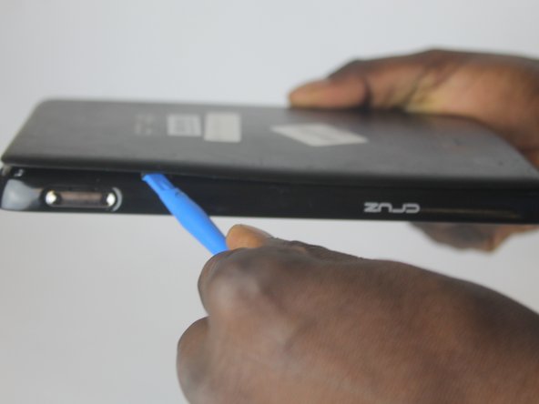

    • Insert the plastic opening tool in the SD port. The edge point should be pointed towards the rear panel.
  2. Velocity Micro Cruz T301 Motherboard  Replacement: crwdns2935265:02crwdnd2935265:01crwdnd2935265:01crwdne2935265:0
    • Insert a small opening tool between the rear panel and the tablet.
  3. Velocity Micro Cruz T301 Motherboard  Replacement: crwdns2935265:03crwdnd2935265:01crwdnd2935265:01crwdne2935265:0
    • The large opening tool is not needed any more.
  4. Velocity Micro Cruz T301 Motherboard  Replacement: crwdns2935265:04crwdnd2935265:01crwdnd2935265:02crwdne2935265:0 Velocity Micro Cruz T301 Motherboard  Replacement: crwdns2935265:04crwdnd2935265:02crwdnd2935265:02crwdne2935265:0
    • Move the small tool opener around the rear panel to free the 12 edges.

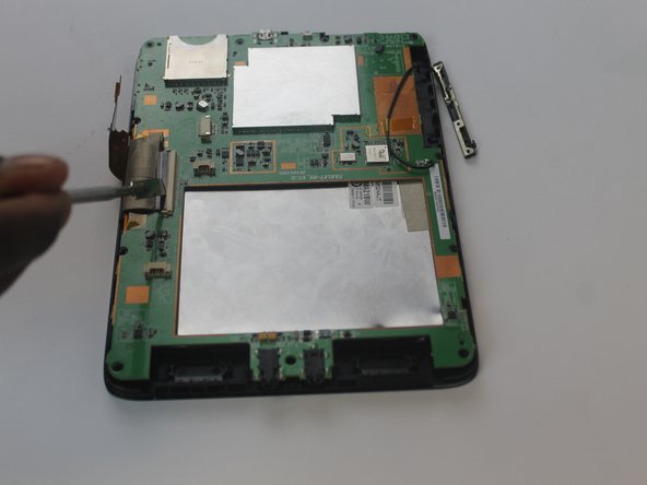

    • Use a nylon spudger to remove the top plug connector from the motherboard.
  12. Velocity Micro Cruz T301 Motherboard  Replacement: crwdns2935265:012crwdnd2935265:01crwdnd2935265:02crwdne2935265:0 Velocity Micro Cruz T301 Motherboard  Replacement: crwdns2935265:012crwdnd2935265:02crwdnd2935265:02crwdne2935265:0
    • Use a metal spudger to remove both screen cable connectors
  13. Velocity Micro Cruz T301 Motherboard  Replacement: crwdns2935265:013crwdnd2935265:01crwdnd2935265:01crwdne2935265:0
    • use openning tools to remove the motherboard.
