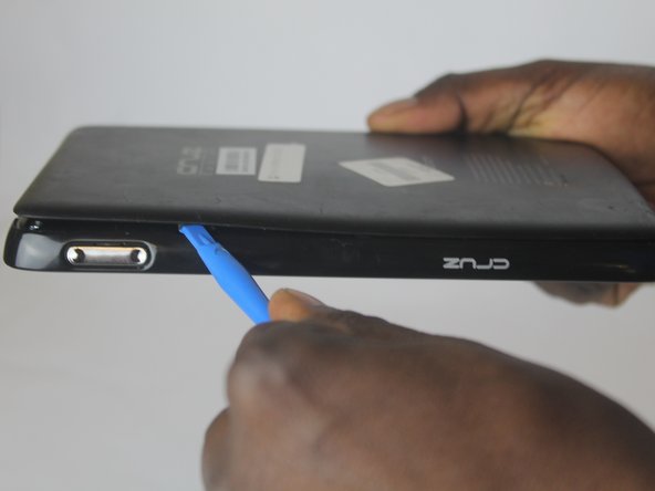

    • Insert the plastic iFixit opening tool into the SD port. Orient the iFixit opening tool so that the edge faces the rear panel.
  2. Velocity Micro Cruz T301 Battery Replacement: crwdns2935265:02crwdnd2935265:01crwdnd2935265:01crwdne2935265:0
    • Use the iFixit opening tools to pry open a gap between the tablet and rear panel.
  3. Velocity Micro Cruz T301 Battery Replacement: crwdns2935265:03crwdnd2935265:01crwdnd2935265:02crwdne2935265:0 Velocity Micro Cruz T301 Battery Replacement: crwdns2935265:03crwdnd2935265:02crwdnd2935265:02crwdne2935265:0
    • Move the small tool opener around the rear panel to free the 12 clips.
