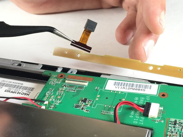

      • Locate the camera as illustrated. Remove the 3 black screws at the top of the tablet.
      • Gently pull back the yellow piece so that the camera may be accessed.
    3. Velocity Micro Cruz Camera Replacement, Remove the Camera: crwdns2935265:03crwdnd2935265:01crwdnd2935265:02crwdne2935265:0 Velocity Micro Cruz Camera Replacement, Remove the Camera: crwdns2935265:03crwdnd2935265:02crwdnd2935265:02crwdne2935265:0
      • Use the tweezers to pull back the black latch on the motherboard that holds the camera.
      • Finally, use the tweezers to remove the camera from the motherboard.
