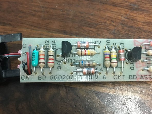

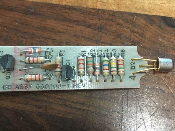

  3. Vectrex Light Pen Disassembly: crwdns2935265:03crwdnd2935265:01crwdnd2935265:03crwdne2935265:0 Vectrex Light Pen Disassembly: crwdns2935265:03crwdnd2935265:02crwdnd2935265:03crwdne2935265:0 Vectrex Light Pen Disassembly: crwdns2935265:03crwdnd2935265:03crwdnd2935265:03crwdne2935265:0
    • The internal board has quite a few tightly packed through-hole components but should easily clear the housing during removal.
    • Now you can marvel at this wonderful little board and perform whatever repairs are needed to bring it back from the dead!
