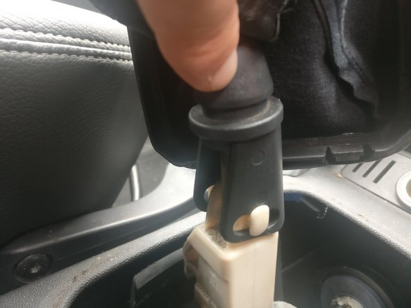

  1. Vauxhall Gear Shift Gaiter Replacement, Examine existing gaiter: crwdns2935265:01crwdnd2935265:01crwdnd2935265:01crwdne2935265:0
    • Examine existing gaiter and take note of how its installed. A quick snap with your camera phone is helpful!

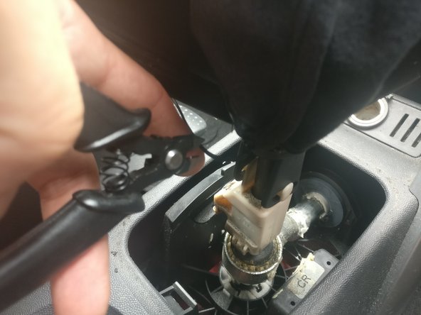

  2. Vauxhall Gear Shift Gaiter Replacement, Remove existing gaiter: crwdns2935265:02crwdnd2935265:01crwdnd2935265:03crwdne2935265:0 Vauxhall Gear Shift Gaiter Replacement, Remove existing gaiter: crwdns2935265:02crwdnd2935265:02crwdnd2935265:03crwdne2935265:0 Vauxhall Gear Shift Gaiter Replacement, Remove existing gaiter: crwdns2935265:02crwdnd2935265:03crwdnd2935265:03crwdne2935265:0
    • Carefully cut through the existing cable tie or chord
    • Pull the gaiter up over the gear knob
