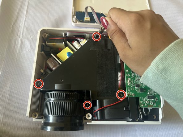

    • Place the projector upside down.
    • Use a Phillips #00 screwdriver to remove the five 1.5mm screws from the base of the projector.
    • Remove the base of the project.
    • There is a cable attached to the motherboard and the bottom case of the projector so don't yank or pull it off.

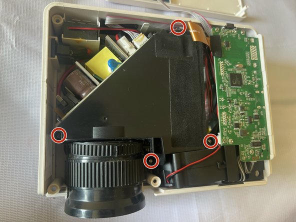

    • Use a Phillips #00 screwdriver to remove four 1.0 mm screws from the black cover.
    • Slowly lift the black triangular shaped cover and gently place it aside.

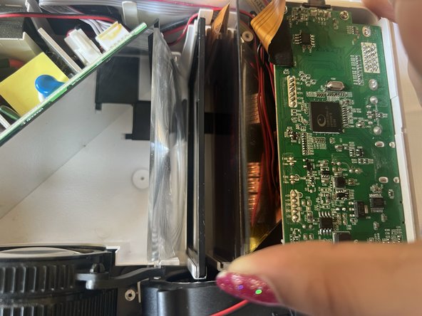

    • Carefully remove the old polarized glass lens by lifting it up and out of the slot.
    • Take extra care while working with the polarized lens glass to avoid breaking it and damaging the projector or getting cut.
  5. Vankyo Projector Leisure 3 Polarized Lens Glass Replacement: crwdns2935265:05crwdnd2935265:01crwdnd2935265:01crwdne2935265:0
    • Gently replace the new polarized glass.
