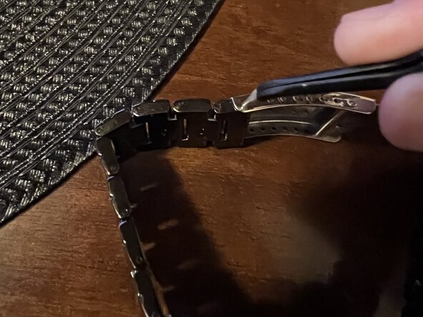

    • Lay the watch on its side just like this
    • Grab tweezers and poke the hole which connects the stainless steel to the band, to disconnect the steel holding it together.
    • The pin should come out. This pin is important so place it somewhere to the side for now. After that, your watch should look like this when laid out flat, allowing you more room to work with to replace your battery.

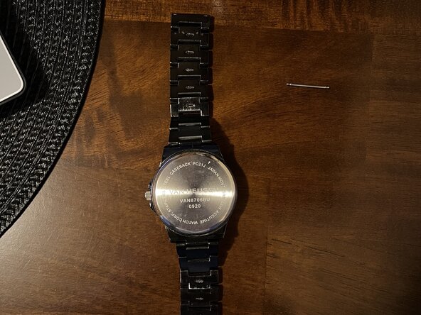

    • Use a Jimmy or watch back removal tool to pry open the stainless-steel case (sometimes there is an arrow that shows you where to pop up for easier access)
  3. Van Heusen PC21J Watch Battery Replacement: crwdns2935265:03crwdnd2935265:01crwdnd2935265:02crwdne2935265:0 Van Heusen PC21J Watch Battery Replacement: crwdns2935265:03crwdnd2935265:02crwdnd2935265:02crwdne2935265:0

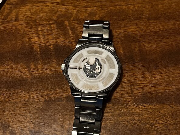

    • Once you pop that case off, it should have this plastic thing that holds the battery in place and everything.
    • Remove that plastic piece.
    • Put it aside along with the pin.

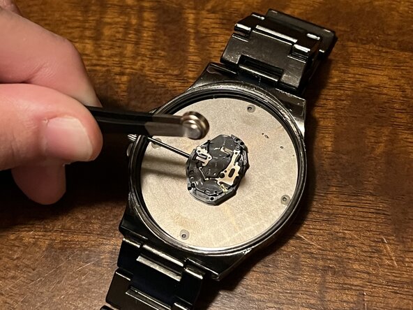

    • Locate the battery. As you can see, I’m pointing it with my tweezers here.
    • Remove the battery. You can either do this by hand or with the tweezers, whatever you feel most comfortable with.
    • Be careful when removing it so you don’t mess up anything.

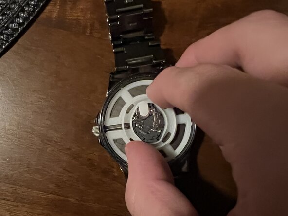

    • Put it back in the same spot where you took out the old battery.
    • Place the plastic back to hold everything down.
  6. Van Heusen PC21J Watch Battery Replacement: crwdns2935265:06crwdnd2935265:01crwdnd2935265:01crwdne2935265:0
    • Now, do everything you did backwards, place the case back on. Press firmly with both your thumbs till you hear or feel it pop back in. Also, put the pin back in the same way you took it out.

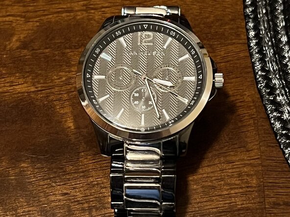

    • After locking the steel with the band again, locate the crown, which is the thing on the side that allows you to move the time around to whatever time zone you may be in.
    • Make sure it is working, and you’ll be good to go!
