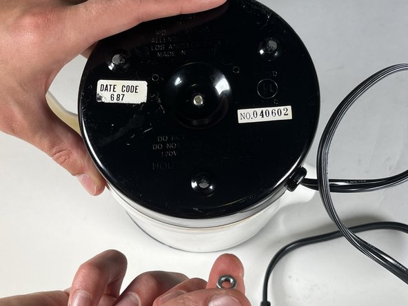

    • Turn the kettle upside down and unscrew the bolt on the bottom.

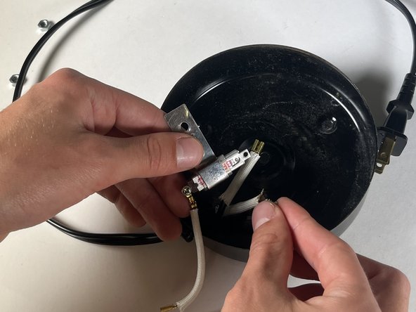

    • Open the plastic base to reveal the wires and heating element.
  3. Valiant Automatic Hot Pot Disassembly: crwdns2935265:03crwdnd2935265:01crwdnd2935265:02crwdne2935265:0 Valiant Automatic Hot Pot Disassembly: crwdns2935265:03crwdnd2935265:02crwdnd2935265:02crwdne2935265:0
    • Unclip the gold brackets attached to the wires from the heating element.

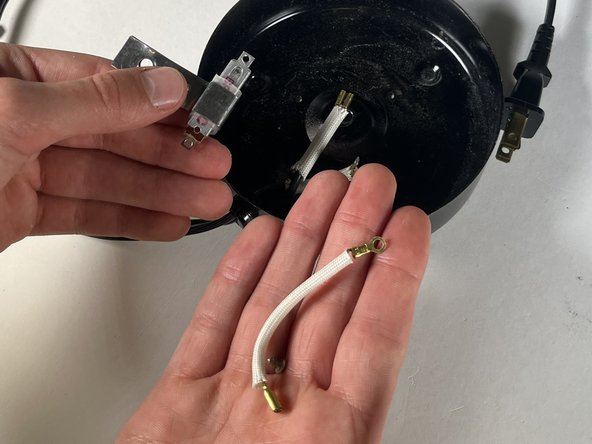

  4. Valiant Automatic Hot Pot Disassembly: crwdns2935265:04crwdnd2935265:01crwdnd2935265:03crwdne2935265:0 Valiant Automatic Hot Pot Disassembly: crwdns2935265:04crwdnd2935265:02crwdnd2935265:03crwdne2935265:0 Valiant Automatic Hot Pot Disassembly: crwdns2935265:04crwdnd2935265:03crwdnd2935265:03crwdne2935265:0

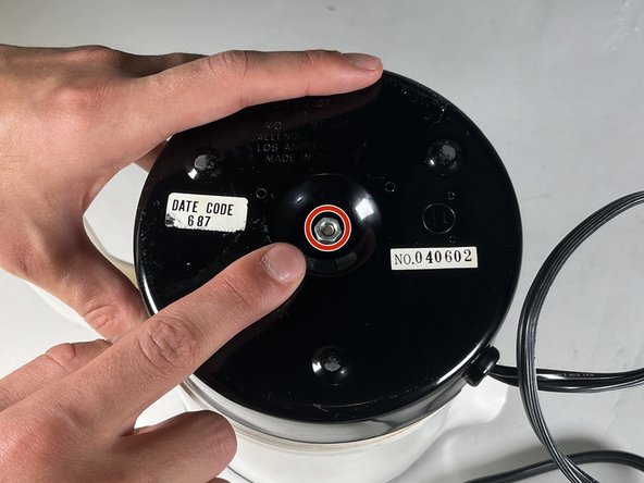

    • Remove the bottom bolt attached to the metal bracket.
    • This should be able to be unscrewed by hand, but if it is stuck, a wrench or pliers may be required.
    • Remove the metal bracket from the screw.
    • Fully remove the black plastic base from the heating element.

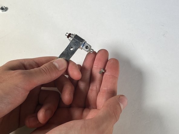

  6. Valiant Automatic Hot Pot Disassembly: crwdns2935265:06crwdnd2935265:01crwdnd2935265:02crwdne2935265:0 Valiant Automatic Hot Pot Disassembly: crwdns2935265:06crwdnd2935265:02crwdnd2935265:02crwdne2935265:0
    • Use a Phillips #0 screwdriver to remove the 1 mm screw holding the T bracket together.
  7. Valiant Automatic Hot Pot Disassembly: crwdns2935265:07crwdnd2935265:01crwdnd2935265:02crwdne2935265:0 Valiant Automatic Hot Pot Disassembly: crwdns2935265:07crwdnd2935265:02crwdnd2935265:02crwdne2935265:0
    • Open the bracket and remove the resistor.
