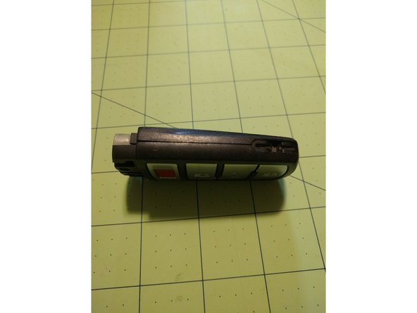

    • What you will need.
    • Key Fob from a 2007 erra VW
    • 2032 coin cell Battery
    • Small flat head screwdriver
  2. VW Key Fob 2007 Passat Replace Battery Replacement, Remove Emergency Key: crwdns2935265:02crwdnd2935265:01crwdnd2935265:02crwdne2935265:0 VW Key Fob 2007 Passat Replace Battery Replacement, Remove Emergency Key: crwdns2935265:02crwdnd2935265:02crwdnd2935265:02crwdne2935265:0

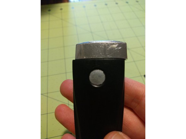

    • Press button to remove plastic emergency key.
  3. VW Key Fob 2007 Passat Replace Battery Replacement, Remove chrome top section.: crwdns2935265:03crwdnd2935265:01crwdnd2935265:03crwdne2935265:0 VW Key Fob 2007 Passat Replace Battery Replacement, Remove chrome top section.: crwdns2935265:03crwdnd2935265:02crwdnd2935265:03crwdne2935265:0 VW Key Fob 2007 Passat Replace Battery Replacement, Remove chrome top section.: crwdns2935265:03crwdnd2935265:03crwdnd2935265:03crwdne2935265:0
    • Push it sideways from the opposite side from the button.
