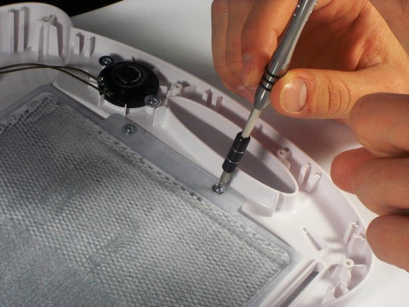

The magnetic screen is an important aspect for the VTech Write and Learn Creative Center because the magnetic screen is one of the interactive ways to engage children to learn by allowing them to write. The following repair guide addresses properly replacing the magnetic screen.
    1. VTech Write and Learn Creative Center Magnetic Screen Replacement, Back Panel: crwdns2935265:01crwdnd2935265:01crwdnd2935265:03crwdne2935265:0 VTech Write and Learn Creative Center Magnetic Screen Replacement, Back Panel: crwdns2935265:01crwdnd2935265:02crwdnd2935265:03crwdne2935265:0 VTech Write and Learn Creative Center Magnetic Screen Replacement, Back Panel: crwdns2935265:01crwdnd2935265:03crwdnd2935265:03crwdne2935265:0
      • Remove all eleven 9mm PH 2 Phillips screws securing the back of the case.
    1. VTech Write and Learn Creative Center Magnetic Screen Replacement, Slider: crwdns2935265:02crwdnd2935265:01crwdnd2935265:01crwdne2935265:0
      • Remove the two 7mm PH 0 Phillips screws holding the slider to the slider handle.
      • The back of the slider will likely be coated in lubricant. Be careful not to make a mess.
    1. VTech Write and Learn Creative Center Magnetic Screen Replacement, Magnetic Screen: crwdns2935265:03crwdnd2935265:01crwdnd2935265:02crwdne2935265:0 VTech Write and Learn Creative Center Magnetic Screen Replacement, Magnetic Screen: crwdns2935265:03crwdnd2935265:02crwdnd2935265:02crwdne2935265:0
      • Remove the four 5mm PH 0 Phillips screws with 7mm heads holding the screen to the front of the case.
    2. VTech Write and Learn Creative Center Magnetic Screen Replacement: crwdns2935265:04crwdnd2935265:01crwdnd2935265:01crwdne2935265:0
      • Gently push the edges of the screen to remove it from the front case.
