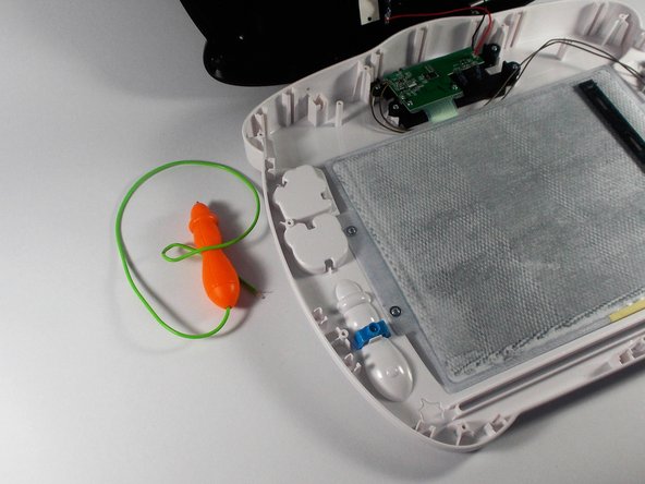

  1. VTech Write and Learn Creative Center Circuit Board Replacement, Back Panel: crwdns2935265:01crwdnd2935265:01crwdnd2935265:03crwdne2935265:0 VTech Write and Learn Creative Center Circuit Board Replacement, Back Panel: crwdns2935265:01crwdnd2935265:02crwdnd2935265:03crwdne2935265:0 VTech Write and Learn Creative Center Circuit Board Replacement, Back Panel: crwdns2935265:01crwdnd2935265:03crwdnd2935265:03crwdne2935265:0
    • Remove all eleven 9mm PH 2 Phillips screws securing the back of the case.
  2. VTech Write and Learn Creative Center Circuit Board Replacement, Magnetic Pen: crwdns2935265:02crwdnd2935265:01crwdnd2935265:01crwdne2935265:0
    • If there is any hot glue, remove it from the base of the wires.
    • During reassembly, reapply the hot glue to the connections to reinforce it's strength.

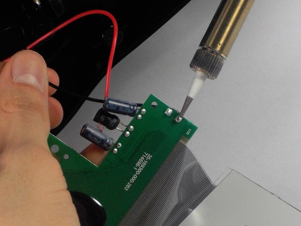

  3. VTech Write and Learn Creative Center Circuit Board Replacement: crwdns2935265:03crwdnd2935265:01crwdnd2935265:01crwdne2935265:0
    • In order to remove the magnetic pen, you must desolder the two wires connecting it to the circuit board.
    • When you desolder, apply the tip of the soldering iron to the soldered joint for approximately 5 - 10 seconds.
    • The soldered joint will turn to a liquid consistency. At this moment, remove the wire and soldering iron.
    • Repeat each of the following steps for the second soldered joint.
    • Soldering irons are dangerously hot. The soldering iron should only come in contact with joints being desoldered or soldered.
    • Make sure to allow time for your soldering iron to heat up before using it.
    • Make sure the tip of the soldering iron is cleaned so the tin on the tip is exposed. This will allow the soldering iron to work efficiently.

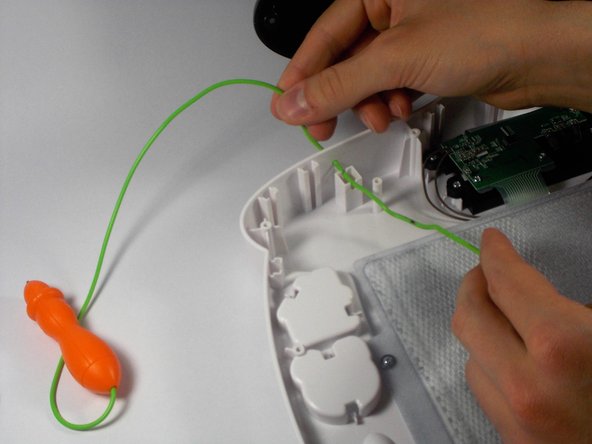

  4. VTech Write and Learn Creative Center Circuit Board Replacement: crwdns2935265:04crwdnd2935265:01crwdnd2935265:03crwdne2935265:0 VTech Write and Learn Creative Center Circuit Board Replacement: crwdns2935265:04crwdnd2935265:02crwdnd2935265:03crwdne2935265:0 VTech Write and Learn Creative Center Circuit Board Replacement: crwdns2935265:04crwdnd2935265:03crwdnd2935265:03crwdne2935265:0
    • Undo the knot, then feed the cord from the inside of the case to the outside using the hole the company originally designed for the cord.

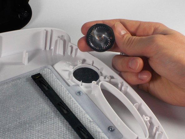

  5. VTech Write and Learn Creative Center Circuit Board Replacement, Speaker: crwdns2935265:05crwdnd2935265:01crwdnd2935265:03crwdne2935265:0 VTech Write and Learn Creative Center Circuit Board Replacement, Speaker: crwdns2935265:05crwdnd2935265:02crwdnd2935265:03crwdne2935265:0 VTech Write and Learn Creative Center Circuit Board Replacement, Speaker: crwdns2935265:05crwdnd2935265:03crwdnd2935265:03crwdne2935265:0
    • In order to remove the speaker, you must desolder the two wires connecting it to the circuit board.
  6. VTech Write and Learn Creative Center Circuit Board Replacement: crwdns2935265:06crwdnd2935265:01crwdnd2935265:02crwdne2935265:0 VTech Write and Learn Creative Center Circuit Board Replacement: crwdns2935265:06crwdnd2935265:02crwdnd2935265:02crwdne2935265:0
    • Remove the 2 5mm PH 0 Phillips screws with 10 mm heads that secure the speaker to the front of the case.

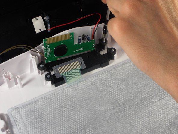

  7. VTech Write and Learn Creative Center Circuit Board Replacement, Circuit Board: crwdns2935265:07crwdnd2935265:01crwdnd2935265:02crwdne2935265:0 VTech Write and Learn Creative Center Circuit Board Replacement, Circuit Board: crwdns2935265:07crwdnd2935265:02crwdnd2935265:02crwdne2935265:0
    • The first part of this step is to remove the hot glue from the base of the wires using the plastic opening tool.
    • The next step if to remove the two 7 mm long PH0 Phillips screws holding the board in.

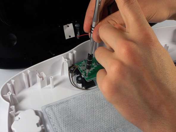

  8. VTech Write and Learn Creative Center Circuit Board Replacement: crwdns2935265:08crwdnd2935265:01crwdnd2935265:03crwdne2935265:0 VTech Write and Learn Creative Center Circuit Board Replacement: crwdns2935265:08crwdnd2935265:02crwdnd2935265:03crwdne2935265:0 VTech Write and Learn Creative Center Circuit Board Replacement: crwdns2935265:08crwdnd2935265:03crwdnd2935265:03crwdne2935265:0
    • Now that the board is free desolder the two wires from the board.
    • Once the wires are desoldered remove the four screws from the black plastic mounting and then take out the circuit board and screen.
    • The ribbon cable connected to the writing surface should pop off he board easily, no soldering required!
    • The screws in the mounting are 7 mm long PH0 Phillips head.
    • Soldering irons and solder get very hot, ensure you are following proper procedure when desoldering the wires.
