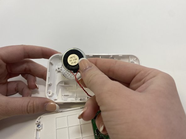

  5. VTech VM3254 Monitor Circuit Board and Screen Replacement, Monitor Speaker: crwdns2935265:05crwdnd2935265:01crwdnd2935265:02crwdne2935265:0 VTech VM3254 Monitor Circuit Board and Screen Replacement, Monitor Speaker: crwdns2935265:05crwdnd2935265:02crwdnd2935265:02crwdne2935265:0
    • Remove the two 7 mm Phillips #00 screws from the speaker.
    • Carefully remove the speaker and its cords from the motherboard.
    • Handle gently to not break the motherboard or any other parts.

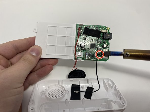

  6. VTech VM3254 Monitor Circuit Board and Screen Replacement: crwdns2935265:06crwdnd2935265:01crwdnd2935265:01crwdne2935265:0
    • Desolder the wire connecting the speaker to the board.

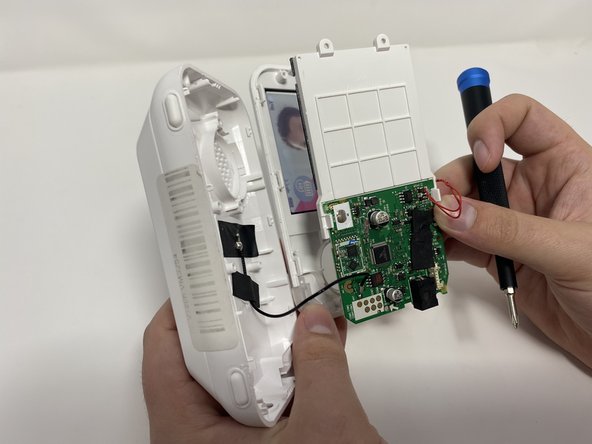

  7. VTech VM3254 Monitor Circuit Board and Screen Replacement, Monitor Circuit Board and Screen: crwdns2935265:07crwdnd2935265:01crwdnd2935265:02crwdne2935265:0 VTech VM3254 Monitor Circuit Board and Screen Replacement, Monitor Circuit Board and Screen: crwdns2935265:07crwdnd2935265:02crwdnd2935265:02crwdne2935265:0
    • Remove the three 8 mm Phillips #00 screws.
    • Gently remove the screen and circuit board from the case.
  8. VTech VM3254 Monitor Circuit Board and Screen Replacement: crwdns2935265:08crwdnd2935265:01crwdnd2935265:02crwdne2935265:0 VTech VM3254 Monitor Circuit Board and Screen Replacement: crwdns2935265:08crwdnd2935265:02crwdnd2935265:02crwdne2935265:0
    • Remove the button assembly from the front of the screen unit.
    • Flip the screen unit back over and desolder the wire holding it to the case.
