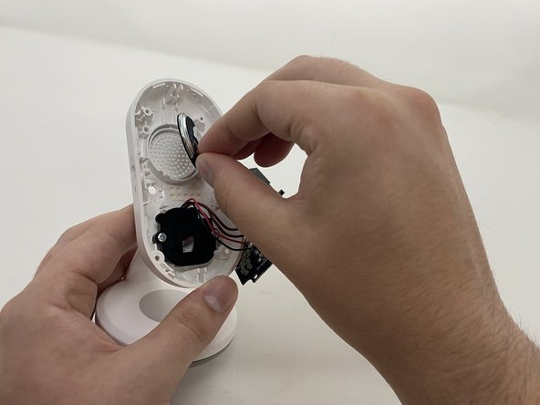

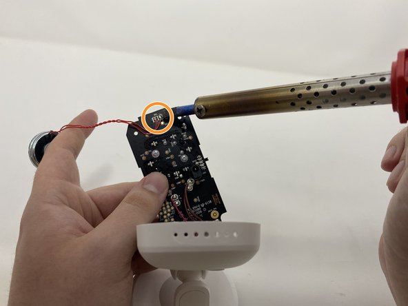

  3. VTech VM3254 Camera Speaker Replacement, Camera Speaker: crwdns2935265:03crwdnd2935265:01crwdnd2935265:03crwdne2935265:0 VTech VM3254 Camera Speaker Replacement, Camera Speaker: crwdns2935265:03crwdnd2935265:02crwdnd2935265:03crwdne2935265:0 VTech VM3254 Camera Speaker Replacement, Camera Speaker: crwdns2935265:03crwdnd2935265:03crwdnd2935265:03crwdne2935265:0
    • Unscrew and remove the two 7 mm Phillips #0 screws that secure the speaker.
    • Remove the speaker.
    • Desolder the speakers cords from the motherboard.
