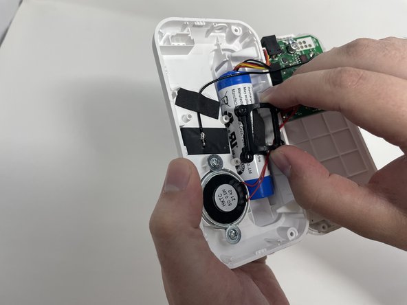

    3. VTech VM3254 Battery Replacement: crwdns2935265:03crwdnd2935265:01crwdnd2935265:02crwdne2935265:0 VTech VM3254 Battery Replacement: crwdns2935265:03crwdnd2935265:02crwdnd2935265:02crwdne2935265:0
      • Remove the four 8 mm Phillips #00 screws from the bracket that secures the battery.
      • Remove the bracket.

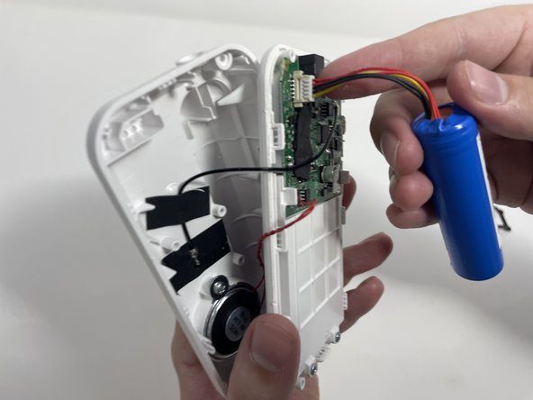

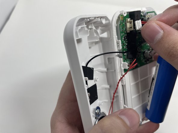

    4. VTech VM3254 Battery Replacement: crwdns2935265:04crwdnd2935265:01crwdnd2935265:03crwdne2935265:0 VTech VM3254 Battery Replacement: crwdns2935265:04crwdnd2935265:02crwdnd2935265:03crwdne2935265:0 VTech VM3254 Battery Replacement: crwdns2935265:04crwdnd2935265:03crwdnd2935265:03crwdne2935265:0
      • Gently remove the battery from its location.
      • Carefully disconnect the bundled cable connector from the circuit board.
