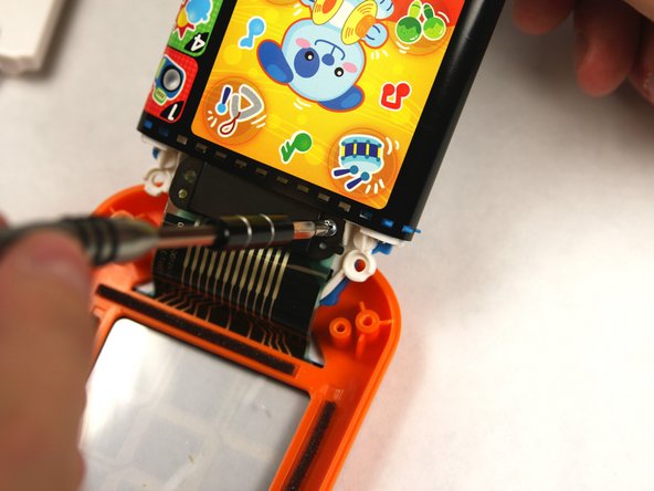

    • Lift the assembly to gain access to the connection point under the assembly.
  14. VTech Touch and Swipe Baby Phone Touchscreen Contact Cleaning: crwdns2935265:014crwdnd2935265:01crwdnd2935265:02crwdne2935265:0 VTech Touch and Swipe Baby Phone Touchscreen Contact Cleaning: crwdns2935265:014crwdnd2935265:02crwdnd2935265:02crwdne2935265:0
    • Remove the two 7.5 mm screws with a Phillips #0 screwdriver.
  15. VTech Touch and Swipe Baby Phone Touchscreen Contact Cleaning: crwdns2935265:015crwdnd2935265:01crwdnd2935265:01crwdne2935265:0
    • With the connector removed, clean both of the boxed sections with rubbing alcohol on a cotton swab. Allow a minute for the alcohol to dry before reassembling.
