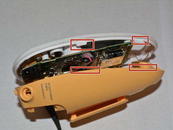

    • Use a plastic opening tool to gently pry along the middle of the 2 sections of the plastic housing in order to release plastic latches on the inside of the housing.
    • Do not take apart briskly or separate the two units completely as they are connected by thin wires.

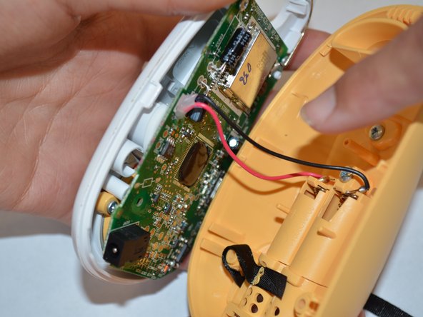

  4. VTech Safe and Sound DM111-2 Parent Unit Motherboard Replacement: crwdns2935265:04crwdnd2935265:01crwdnd2935265:02crwdne2935265:0 VTech Safe and Sound DM111-2 Parent Unit Motherboard Replacement: crwdns2935265:04crwdnd2935265:02crwdnd2935265:02crwdne2935265:0
    • Gently pull apart the two housing component taking care not to damage the wire connecting them.
    • Check the wire connections from the battery compartment to the motherboard for any cuts, burn marks, or loose wires.
    • Likewise check the soldering joints for the antenna, and the power jack, and speakers, in order to make surethe issue is with the motherboard and not the wires or other components.

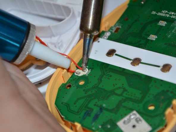

    • Free the motherboard by unscrewing the two 4mm phillips head screws at the top of the motherboard
    • Flip over the motherboard and de-solder the wires connecting the speaker to the motherboard
