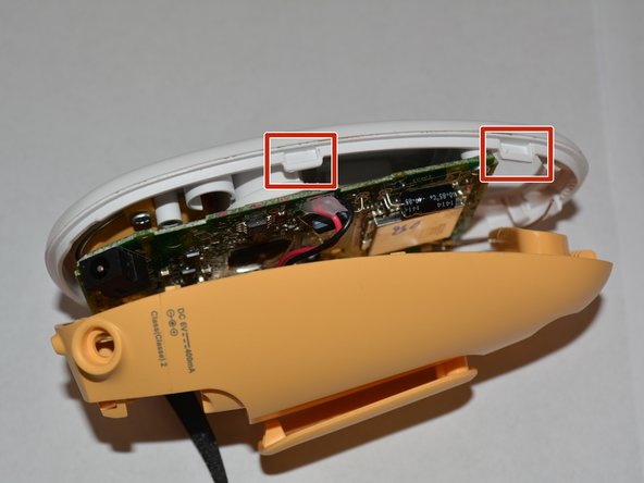

  4. VTech Safe and Sound DM111-2 Button Replacement: crwdns2935265:04crwdnd2935265:01crwdnd2935265:02crwdne2935265:0 VTech Safe and Sound DM111-2 Button Replacement: crwdns2935265:04crwdnd2935265:02crwdnd2935265:02crwdne2935265:0
    • The white front covering of the device is held to the yellow back covering by four clips.
    • When separating the front and back cover, be careful not to separate the red and black wires which connect the batteries to the motherboard.
    • Insert the plastic opening tool into the seam between the front and back coverings to create a gap. The tools edge should point toward the front covering. Start from the bottom of the device and slide the tool around the seam until all clips have been separated from the tabs.

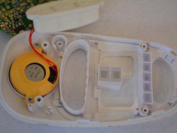

  5. VTech Safe and Sound DM111-2 Button Replacement: crwdns2935265:05crwdnd2935265:01crwdnd2935265:02crwdne2935265:0 VTech Safe and Sound DM111-2 Button Replacement: crwdns2935265:05crwdnd2935265:02crwdnd2935265:02crwdne2935265:0
    • When separating the motherboard from the front cover, be careful not to disconnect the two red wires which connect the speaker to the motherboard.
    • Remove the two 6.8 mm Philips #00 screws located on the top left and right corners of the motherboard.
    • Gently lift the motherboard away from the speaker case.
    • Remove old buttons and place new buttons into the button slot.
    • If button issues continue after button replacement, refer to the motherboard replacement guide.
