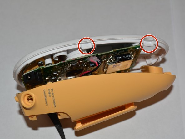

    • Insert the plastic opening tool into the seam between the front and back coverings to create a gap.
    • The tools edge should point toward the front covering. It is easiest to start from the bottom of the device and slide the tool around the seam until all clips have been separated from the tabs.
    • When separating the front and back cover, be careful not to separate the red and black wires which connect the batteries to the motherboard. Do not forcefully pull the two coverings apart.

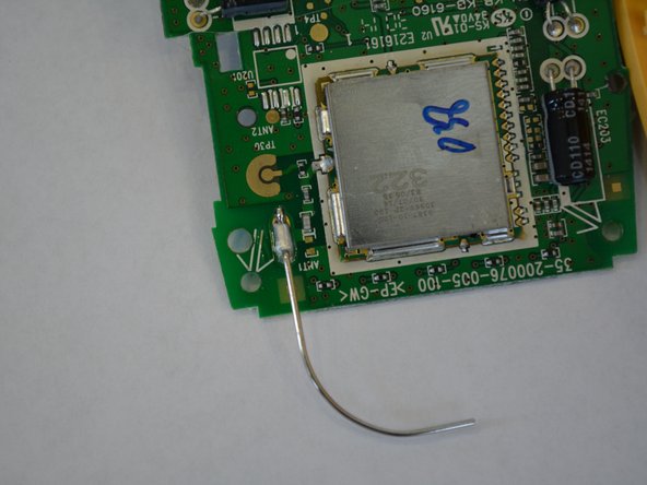

    • Unscrew the two 6.8 mm Phillips #00 screws located on the motherboard.
    • When separating the motherboard from the front cover, be careful not to separate the two red wires which connect the speaker to the motherboard.

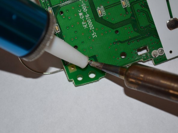

    • Once you've safely detached the two units, now relocate the Antenna. Flip the device and locate the solder points.
    • Using a Soldering Iron, detach the Antenna and solder a new antenna.
