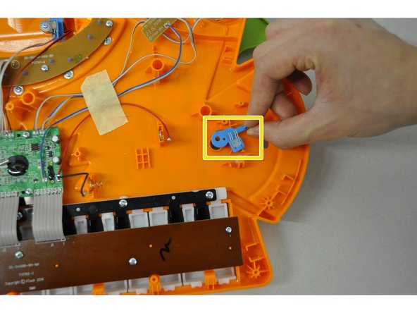

    • Remove PH2 screw (5 mm) from yellow/gold colored circuit board and pull back to access the whammy component.
  3. VTech Record and Learn KidiStudio Whammy Bar Replacement: crwdns2935265:03crwdnd2935265:01crwdnd2935265:02crwdne2935265:0 VTech Record and Learn KidiStudio Whammy Bar Replacement: crwdns2935265:03crwdnd2935265:02crwdnd2935265:02crwdne2935265:0
    • Remove 3 PH2 (5 mm) screws connected to the whammy bar component.
    • Remove blue piece from back of the device. This will free the whammy bar. Replace the whammy bar with new part.
