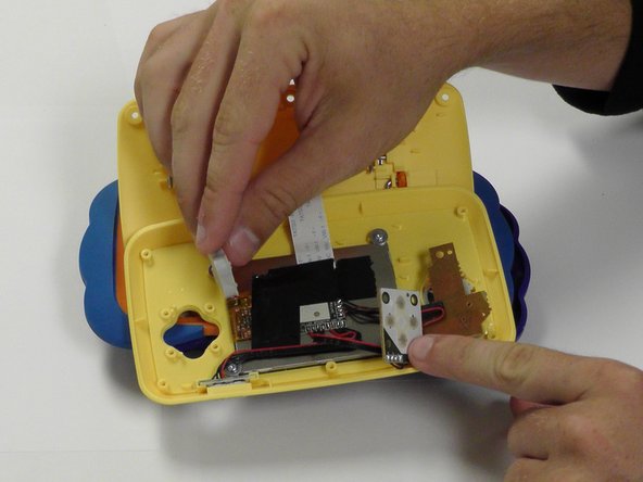

This guide show users how they can replace the buttons of the device.
    1. VTech MobiGo Touch Learning System Buttons Replacement, Case: crwdns2935265:01crwdnd2935265:01crwdnd2935265:01crwdne2935265:0
      • Remove the battery covers and the four batteries.
    2. VTech MobiGo Touch Learning System Buttons Replacement: crwdns2935265:02crwdnd2935265:01crwdnd2935265:02crwdne2935265:0 VTech MobiGo Touch Learning System Buttons Replacement: crwdns2935265:02crwdnd2935265:02crwdnd2935265:02crwdne2935265:0
      • Remove the four plastic caps with a metal spudger to expose the 6.0 mm Philips JIS #0 case screws.
      • Remove the eight 6.0 mm JIS #0 case screws.
    3. VTech MobiGo Touch Learning System Buttons Replacement: crwdns2935265:03crwdnd2935265:01crwdnd2935265:02crwdne2935265:0 VTech MobiGo Touch Learning System Buttons Replacement: crwdns2935265:03crwdnd2935265:02crwdnd2935265:02crwdne2935265:0
      • Using a plastic opening tool, separate the two pieces of the case carefully.
    1. VTech MobiGo Touch Learning System Buttons Replacement, Disassembling VTech MobiGo Touch Learning System Screen Enclosure: crwdns2935265:04crwdnd2935265:01crwdnd2935265:01crwdne2935265:0
      • Remove the three 4.0 mm Philips J0 screws holding the "L" shaped brackets in place.
    2. VTech MobiGo Touch Learning System Buttons Replacement: crwdns2935265:05crwdnd2935265:01crwdnd2935265:01crwdne2935265:0
      • Remove the three "L" shaped brackets and the spring.
    3. VTech MobiGo Touch Learning System Buttons Replacement: crwdns2935265:06crwdnd2935265:01crwdnd2935265:01crwdne2935265:0
      • Flip the device over and remove the three 4.0 mm Philips J0 case screws.
    4. VTech MobiGo Touch Learning System Buttons Replacement: crwdns2935265:07crwdnd2935265:01crwdnd2935265:01crwdne2935265:0
      • Separate the front and back of the case.
      • Use a plastic opening tool if necessary.
    1. VTech MobiGo Touch Learning System Buttons Replacement, Buttons: crwdns2935265:08crwdnd2935265:01crwdnd2935265:01crwdne2935265:0
      • Remove 6 (3.8 mm Philips J0) screws holding the buttons in.
    2. VTech MobiGo Touch Learning System Buttons Replacement: crwdns2935265:09crwdnd2935265:01crwdnd2935265:02crwdne2935265:0 VTech MobiGo Touch Learning System Buttons Replacement: crwdns2935265:09crwdnd2935265:02crwdnd2935265:02crwdne2935265:0
      • From here you can remove and replace the buttons.
