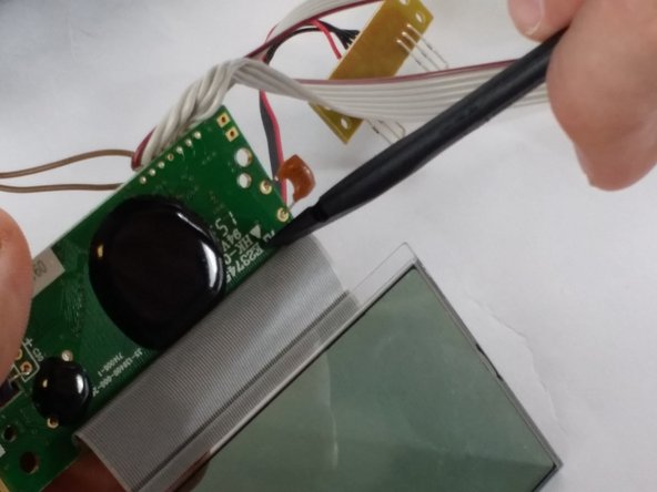

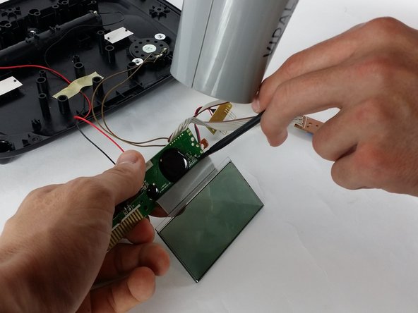

    1. VTech Little Apps Tablet Screen Replacement, Screen: crwdns2935265:010crwdnd2935265:01crwdnd2935265:01crwdne2935265:0
      • Remove the three 7.3mm screws securing motherboard to the device shell.
      • When resecuring the motherboard, avoid over-tightening the screws. Too much pressure could damage the motherboard.
      • Pay attention to the setup of the light-blue ribbon cable located under the motherboard, and use this information for reassembly.
    2. VTech Little Apps Tablet Screen Replacement: crwdns2935265:011crwdnd2935265:01crwdnd2935265:03crwdne2935265:0 VTech Little Apps Tablet Screen Replacement: crwdns2935265:011crwdnd2935265:02crwdnd2935265:03crwdne2935265:0 VTech Little Apps Tablet Screen Replacement: crwdns2935265:011crwdnd2935265:03crwdnd2935265:03crwdne2935265:0
      • Carefully lift both the screen and motherboard, to access to the ribbon cable underneath.
      • Use a heat gun (or hair dryer) to apply low heat to the ribbon cable attachment on the motherboard.
      • Avoid overheating the ribbon cable and motherboard or they may melt.
      • Carefully use a nylon spudger to separate the ribbon cable from the motherboard and remove the screen.
      • This step may require two sets of hands; having a friend always helps!
