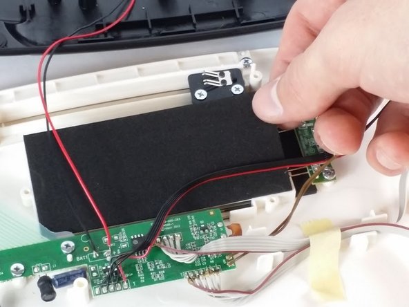

    1. VTech Little Apps Tablet LED Replacement, LED: crwdns2935265:05crwdnd2935265:01crwdnd2935265:01crwdne2935265:0
      • Unscrew the two 7.3 mm screws using a PH0 driver head.
      • Gently lift the beige circuit board and set aside.
      • Be sure to not damage the wires connecting the circuit board to the motherboard, you are only creating space to work in.
    2. VTech Little Apps Tablet LED Replacement: crwdns2935265:06crwdnd2935265:01crwdnd2935265:02crwdne2935265:0 VTech Little Apps Tablet LED Replacement: crwdns2935265:06crwdnd2935265:02crwdnd2935265:02crwdne2935265:0
      • Unscrew three 7.3 mm panhead screws with the PH0 driver.
      • Remove the red-brown washer after removing the screws.
      • Remove the black foam insert and set aside.

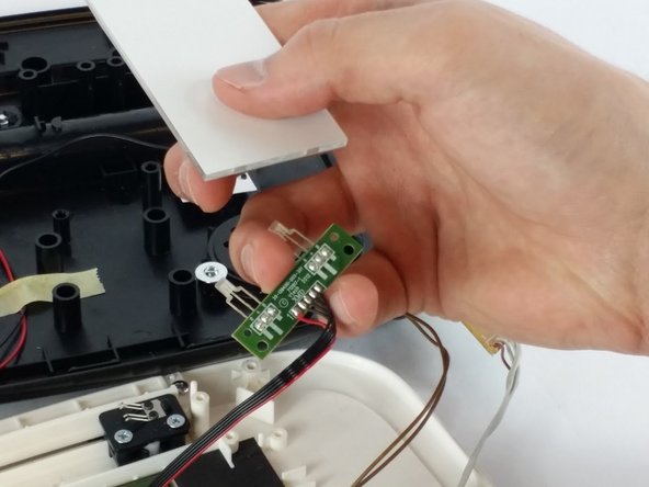

    3. VTech Little Apps Tablet LED Replacement: crwdns2935265:07crwdnd2935265:01crwdnd2935265:01crwdne2935265:0
      • Unscrew the 7.3 mm screw fastening the LED circuit board to the device shell with a PH0 driver head.
      • Be careful when rescrewing circuit boards. Too much pressure or too tight of screws could damage them.
    4. VTech Little Apps Tablet LED Replacement: crwdns2935265:08crwdnd2935265:01crwdnd2935265:02crwdne2935265:0 VTech Little Apps Tablet LED Replacement: crwdns2935265:08crwdnd2935265:02crwdnd2935265:02crwdne2935265:0
      • Gently lift both LED circuit board and the white glass light refractor panel away from the device.
      • Separate the LED circuit board and light refractor panel by gently pulling apart. Place the light panel to the side.
      • Skip the next step if you are proceeding with this guide as a part of the Screen Replacement.
    5. VTech Little Apps Tablet LED Replacement: crwdns2935265:09crwdnd2935265:01crwdnd2935265:01crwdne2935265:0
      • Carefully desolder the LED leads (labeled "R", "+" and "B" on the circuit board) to disconnect the LED from the circuit board.
      • Replace the LED and solder the new connection to the LED circuit board.
